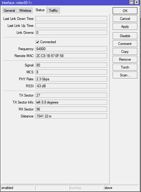

hi
i have nray 60ghz
64800 mhz only works 1541 m distance and RSSI -61 ; signal/msc 80/8
58320 unstable
60480 unstable
62480 unstable
but, on light rain, normal rain .. drop drop drop
is that normal or defective device ? or distance is too high ? 1541 m?
on sunny day, al good
judging from signal strength - your alignment is way off.
see picture, and allday say 0,4
right now is 0,8
but, when is rain .. go down, so i decide to give up with cambium force 300-25 5ghz
The center position on the nRAY is 31, it is hard to find
Also the TX sector info goes 0.2-0.8 then it changes TX sector, its not your off 0.2 degree
From my experience, best would be to align tx/rx sector to 0.2 degrees, “centered” has not been implemented yet on nRAY and 0.2 is the closest you can get
