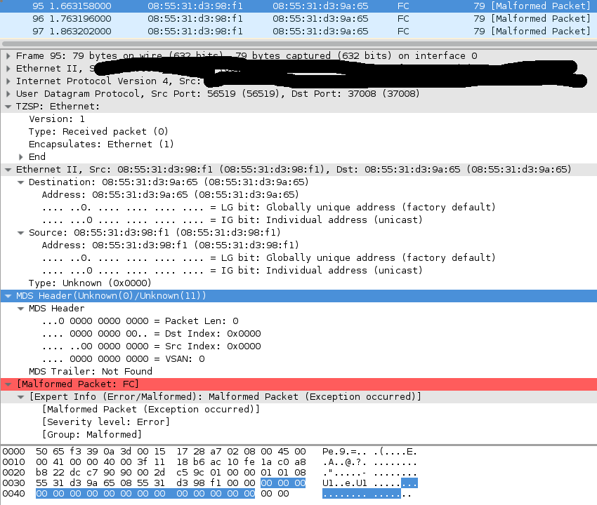

  • Before hang w60g interface generates about 400k of traffic with ethertype=4 between wireless side macs (I changed bridge mac not to match it, clearly traffic is directed only to radio interface)
  • Captured traffic on w60g interface via packet sniffer & wireshark. Seems unknown to me, but src and dst macs is w60g radio interfaces.

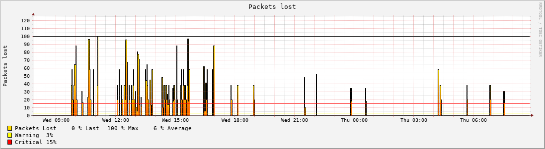

On this graph each spike represents device reboot.

I think that passing some broadcast/multicast (since there is no proper unicast packets without failed optics) packet brings down links.

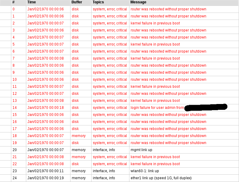

Update:
Updating 7.1rc1 is even more unstable.
Very frequent reboots in 1-2 minutes:
supout.rif is not informative also:

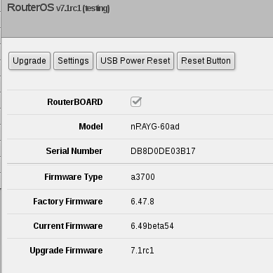

Can you do a screen shot of the Routerboard TAB
Which devices? All four?
I think there is software problem (as hanging only one, station side), warranty will not cover it. Or it does?
Routerboard screenshots for example:
Already updated bootloader with beta, was stock in the beginning of testing.
