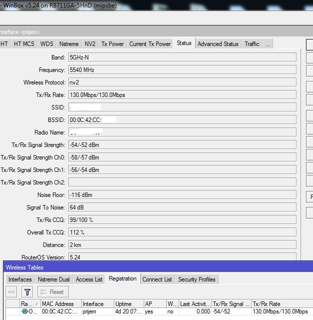

Hello. We have 1,5km 2x2 P2P link with dual parabolic antenas. All works fine with NV2, both sides have 5.24
Troughput is 55Mbit. CCQ and link uptime is good.
But when I change protocol to Nstream, then periodic disconnect. Why?

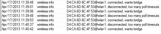

if you have problems with Nstreme wireless protocol with lot of disconnection “too many poll timeouts” please write to support and also provide us remote access to both ends so we could check why it is disconnecting so frequency.

True, nstream no longer works ok. The last 15 days I have commissioned 10 new links based on the RB911 and JRC duplex 24 antennas. Signals on the links are -50 to -60 but none of the links with active NSTREAM has no uptime higher than 2h. Log on the client side says “lost connection, not polled for too long” and log the AP side “disconnected, too many poll timeouts”. Please note that the area is absolutely without interference. On RouterBOARD is OS version 6.1 and version 3.07 firmware. So, 10 links on 10 different places, interference-free area. With NV2 everything works ok but with big jitter, ping varies 4-50 ms.

I did not say it’s a known bug. it is a simple error message (poll timeout). it can indicate all kinds of things.
