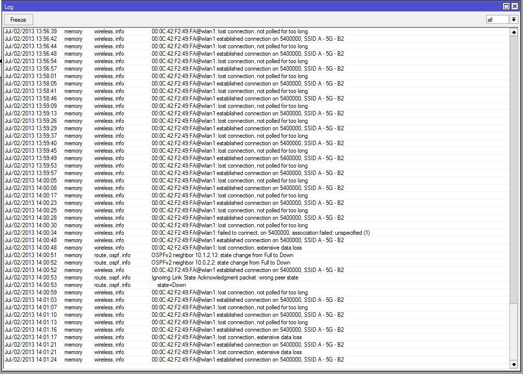

I have read all the posts related to similar problems but have not found anything concrete…

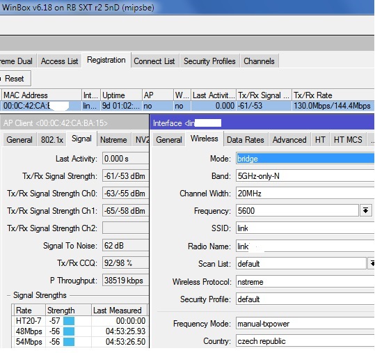

We have P2P link on cca 12km, jirous dish (MIMO 29 dBi) anthenna on bot sides. One side is RB433GL with R52HN card, other side RB711-5HnD.
Signal streinght is 60/60 ccq: 98/98…100/100
Spectrum is completely free and there is no interference on 5Ghz band and this channel.
Must use nstreme becouse I can not afford the high ping (nv2).
I thought it was a problem in nstreme and “5Ghz-n” wireless mode but now conf. is in “5Ghz-a” mode and it is the same…
Client side report ewery 30-60 min:lost connection, not polled for too long
Bridge: disconnected, too many poll timeouts

The link performance is more than the expectation, but it drops or have low data rate frequently.
Mikrotik recommend to enable wireless FP package, reset resting and reconfigure, upgrade to the latest test version of ROS.. nothing solve the problem.
note that after upgrading to the latest version, now I have no logs with the error I have before the upgrade such as (management protection failure. / ether1 link down, ether1 link up. / no network that satisfies connect-list, by default choose with strongest signal. / failed to select netwrok. / delaying scanning… must select a netwok… empty. / wlan1: failed to set bridge port for wlan1, reason: device already added as bridge port (6)…
Now I don’t have any of these logs, but the same problem with the same occurrence frequency.
restarting the one of the RB was solving the problem when the link drops.
after upgrading the link doesn’t drop, but it have very low performance most of the time..

Are use only 2x2 or 1x1 chain ? My test resolution 1x1 work fine nstream on 64QAM modulation , but change the settings to dual chain random disconnection and slow speed !
After 6.7 we have no problem with 2x2 nstream. This is P2P link. 2x2, hw retries 15, 2,3km distance.
No problem with speed and disconnect. Works well from 6.7. Now with 6.18. Uptime is only 9days because - power outage
