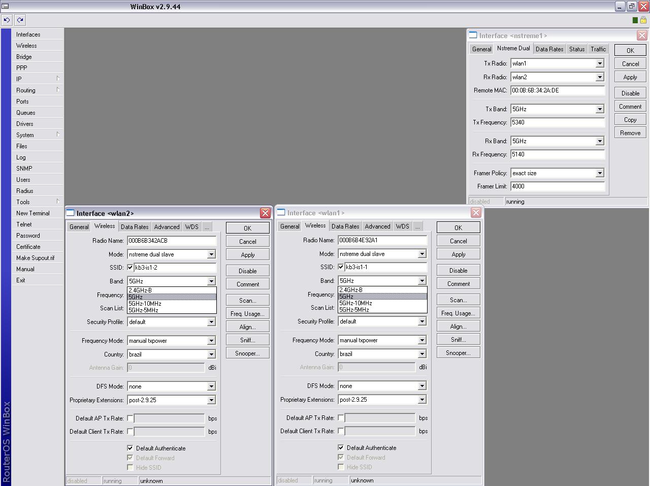

you can see in the print screen what my options are.
Are you sure about that?
I have a 2.9.38 Nstreme2 link and it works fine on turbo mode.
The problem is Brazil, change the country.
Best regards
I’ll change the country to something else tonight. I can’t make changes tonight currently as the are a constant stream of calls going through there. I’ll change it tonight. The only reason we set it to Brazil is because the choice of requencies are much more.
Also, check for the CPU load.
set country to no_country_set
