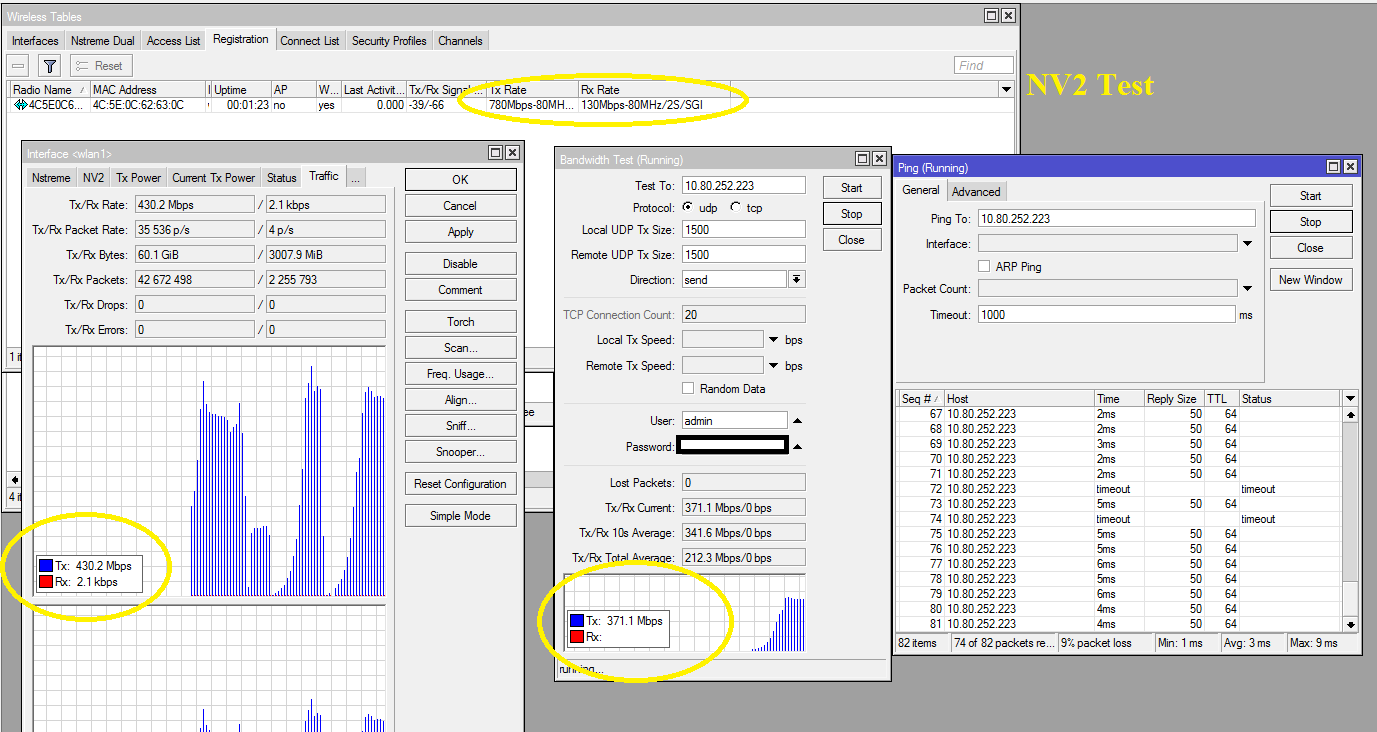

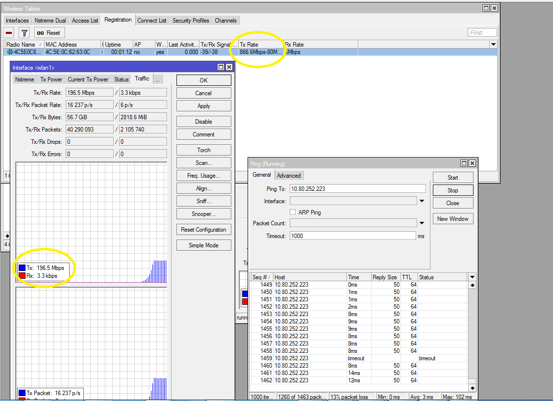

Just wanted to alert Mikrotik of this, of all my outdoor testing with these Netbox5’s, SXT-AC, and NetMetal, with rates MAXED OUT, Nstreme caps out at 170-180Mbps!!! NV2 only links at 680-720, but get 200-300Mb throughput!!
Obviously seems to be an issue with Nstreme+AC and the 170/180 throughput, hoping Mikrotik can fix it soon, as I LOVE the 0-1ms latency with Nstreme
Also the traffic graphs during speedtest seem to be off. Look below with NV2

Bout 1.5 miles. Already reduced TX on both ends to 10db. That’s not the problem though. Because same exact issues on the next link out from this one that is 7.8miles and signals -54/-53
use a pc to do speedtest not the routerboard itself
I can push 980mb UDP to the master side from our core CCR so its not a bandwidth testing issue. Speedtest on laptop was ~160mb with data rates 866/866.
