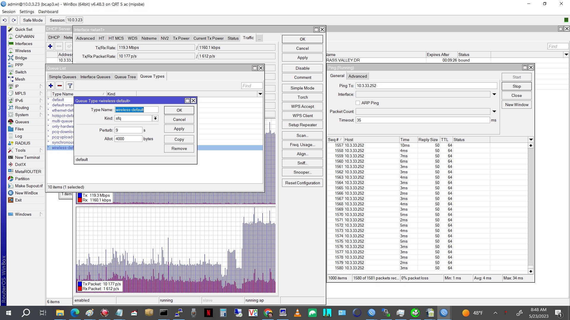

have Wireless interface @ Wireless-default, then modified SFQ to perturb 9 with 4000 bytes (tried 2000000 and 11 but it was lossy. Figured 4000 to match NV2 packet size)

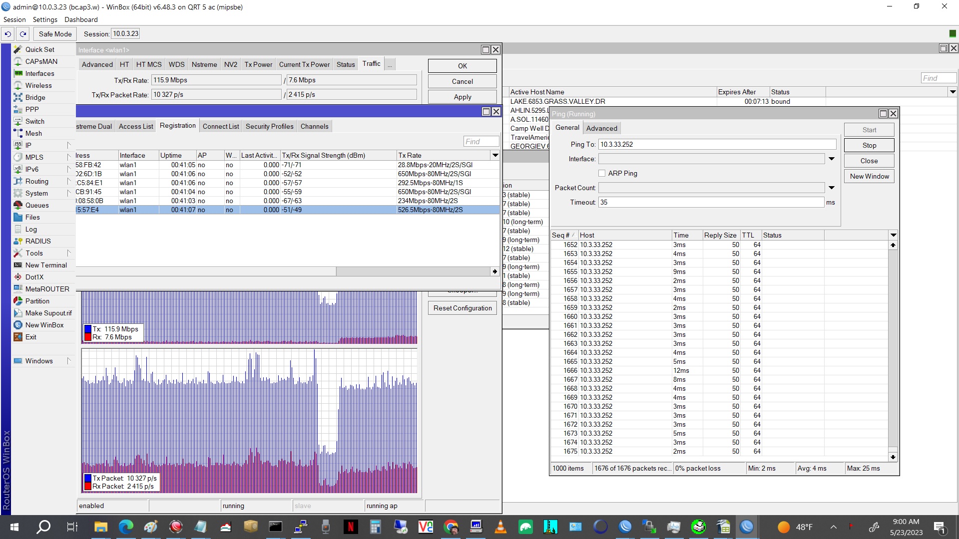

Ran send test with 25mbit to one client (dynadishAC) from another core device in the network
Ran simultaneous send test with 20mbit to another client(QRTAC) on the same ap from another core device in the network
Then on the AP, ran ping test with default packet size and 35ms to the client who was experiencing packet loss.
No longer seeing any drops after modifying the SFQ to 9/4000.
Ran the test up to 85 mbit and 20 respectively from the two btest TCP generators (ccr1009 somewhere on my core ptp network) Still no loss.
AP @ 6.48.3 as well as client
Ran test up to 40mb tcp from one ccr
and 80 mb tcp from other ccr.
120 m aggregate to test clients radios (result - no loss! or jitter from AP to client over 35 ms.)
So I ran another test, this time reducing the TX to 65 and increasing the RX for both test to that client 33.252 (the client complaining about packet loss)
Still got 120x5 and no packet loss.
Surprisingly this config seems to work. I’ve been thinking for years the trick is to match up the TCP needs with the NV2 needs.
Both clients are at 3KM and 2KM with -50 signal.
I’ve not changed the Queue type at the far side from Multi-queue-ethernet default for both interfaces on the client. I’m really surprised at the results. It seems the more traffic on the interface the less loss there is. I ran test for about 7000 packets and didn’t drop a single one to the client receiving 80 mbit, while the other client RX 40M - It’s also 9 AM and I didn’t do anything to hamper other clients traffic on the cell. I’m really happy with the test results on this AP.
