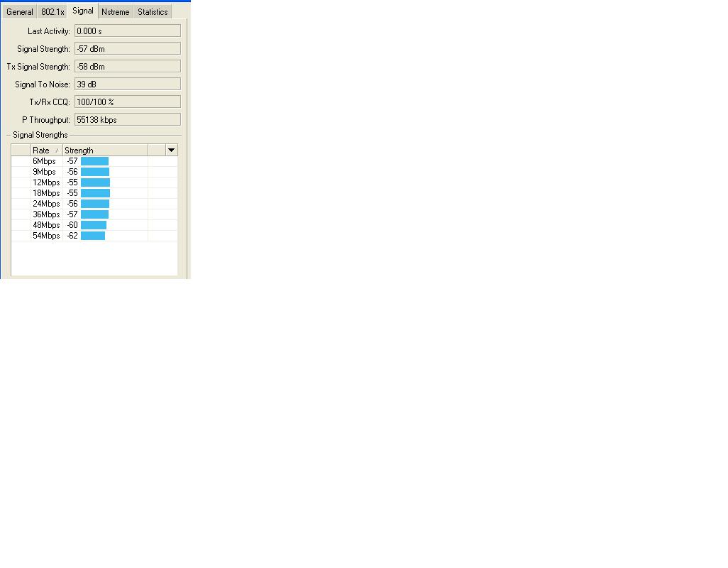

I’ve been trying to figure this one out for several weeks. Several PtP links that have always been stable will disconnect with “received deauth: class2 frame received (6)” They instantly reconnect.
Most of them have great link. Main one has a 97-100 ccq both rx/tx, 55-59 dbm both rx/tx. Very rarely flutuates.

It seems that this started after going from 3.xx to 4.5. Sometimes they will stay up for couple of days, but usually will do this at least once a day. I have client snr logging every 30 minutes, and don’t see any signal decreases. I’ve logged in one minute later and it’s perfect.
