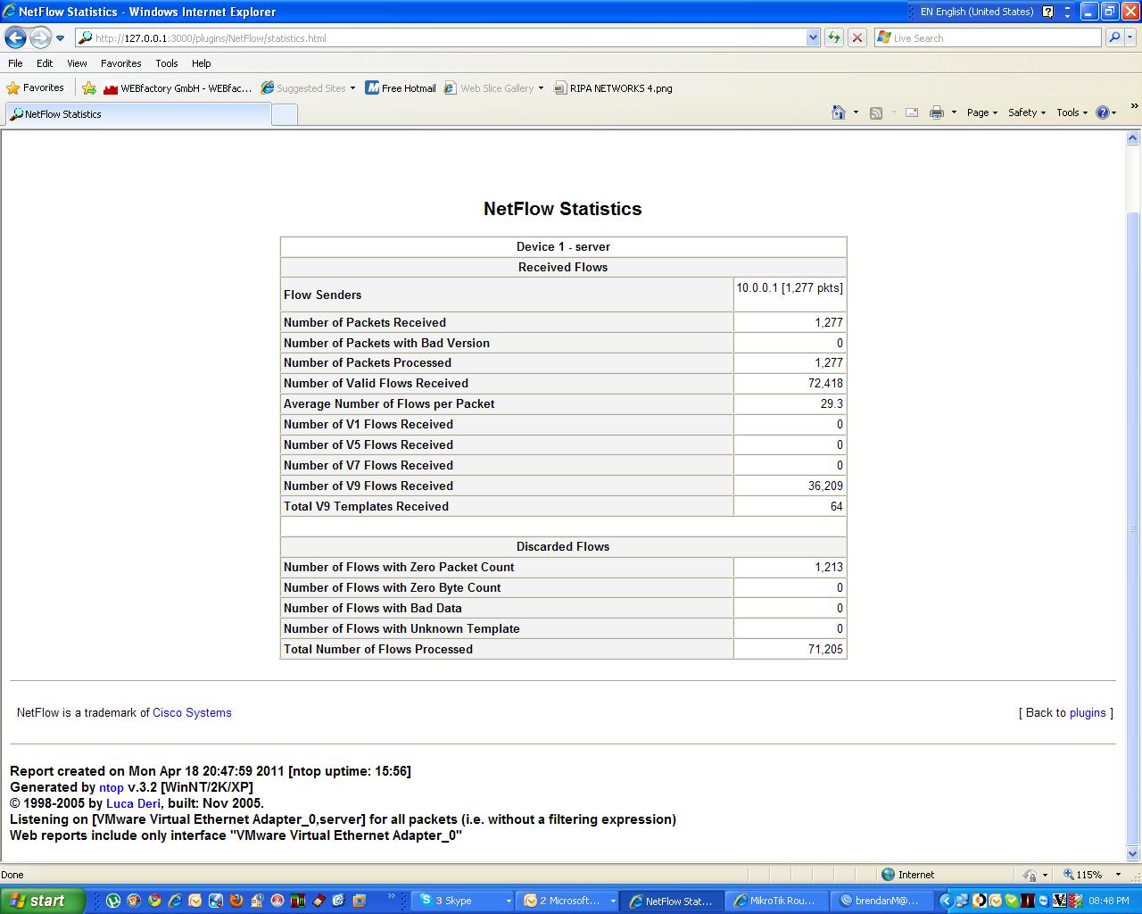

trafic flow verstion 9 does it work

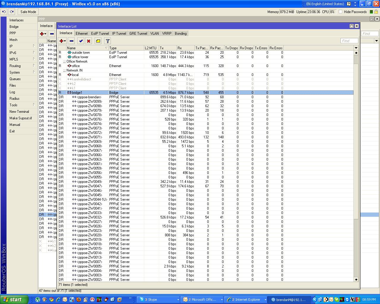

could some one help me add main mikrotik server to ntop as it seems right but not all info comes up
tryed v5 and 9
must i add something in ntop ???

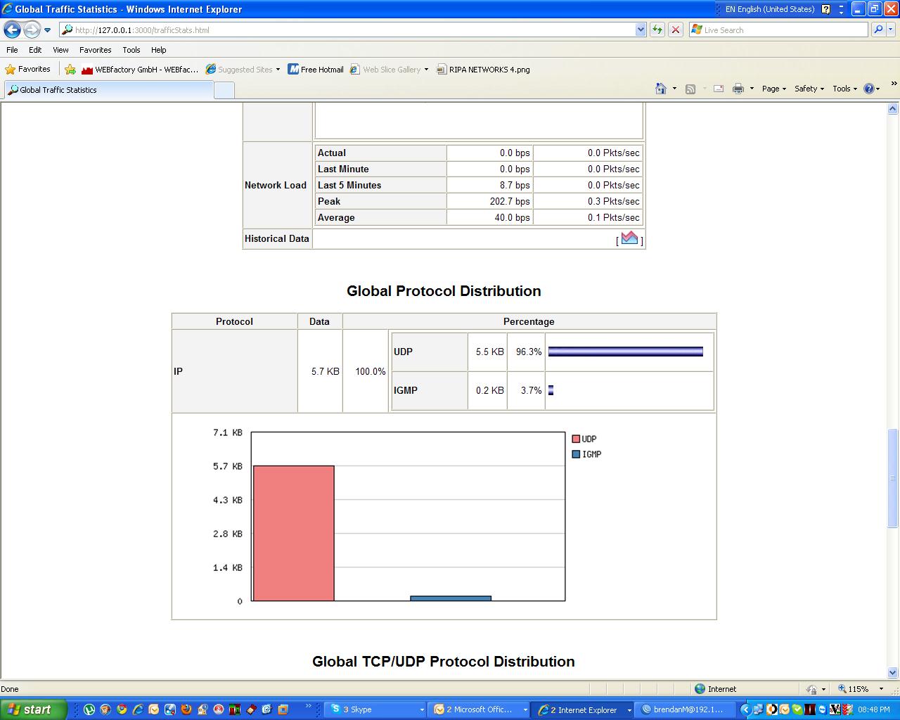

as i dont seem to get all ip info from it im running at 5 meg of data but not dont show it
this is all the traffic from mikrotik but on ntop i get no ip info or usage
afair, somebody posted that NFv9 sends zero packet count - seems like you see it in ‘Discarded Packets’
write to support@ =)
even in other versions not just V9
V5 also
is this a bug in V5 ROS?
for NFv5 you have rejects with ‘zero packets’ reason?.. that’s strange… I just checked one of my routers (v5.0) - NFv5 data seems correct
i get this on v5
