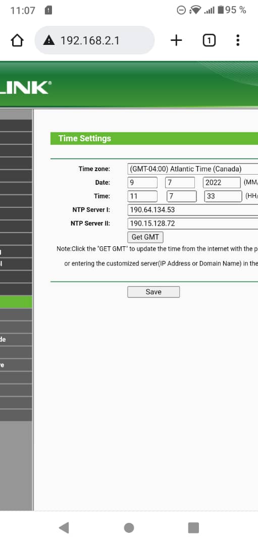

Behind the RB750GL I have a TP-LINK router which uses as primary NTP server 190.64.134.53 and secondary 190.15.128.72 and if it synchronizes the time normally

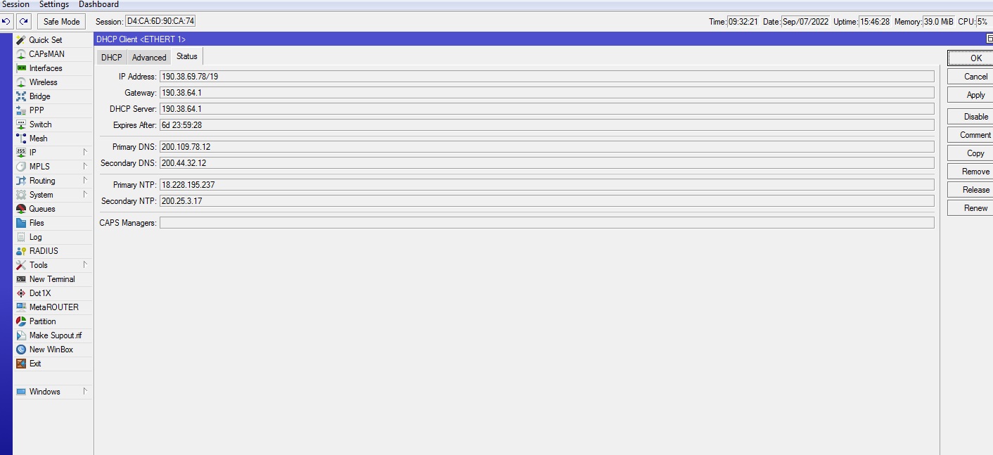

Here is what appears in my RB

Do other devices get NTP? It may be that your ISP block port UDP 123. Than it will not help anything you do with your MirkoTik Router
