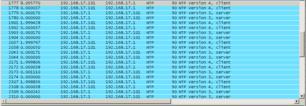

I have a situation where my network (Network 1) is made up of 3 RouterOS (Router A, B, C - all with NTP Package) and various Windows servers and clients. Router C is connected to a vendor network (Network 2) with what I was told is an NTP server (ExtTimeServer). It seems that Router C will connect to the ExtTimeServer server but will not synchronize.
It never changes from status: reached to status: syncrhonized.
I also ran packet sniffer and it shows NTP Version 4 from Router C (192.168.17.101) and NTP Version 3 from ExtTimeServer (192.168.17.1)

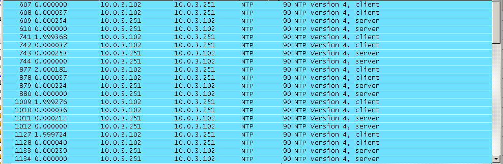

I then configured Router C (10.0.3.102) to look at Router B (10.0.3.251) for NTP. Router C immediately synchronized.
From what I have read NTP Version 3 and 4 should be compatible? Is it possible the ExtTimeServer uses SNTP?
If so, am I correct in assuming you cannot use an SNTP time server to set RouterOS time that has NTP package installed?
