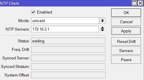

Configured R1 as NTP SRV and for others as a client now:
like images as you can see everything is set yet, the statue of client is in “waiting” right a few hours ago I did it but this time no!

What kind of server is that 172.16.3.1?
Maybe a Windows server? That does not always work correctly.
Try with a true NTP server, when not available use one on internet.
My guess: OP entered router’s own IP address thinking it’s about which IP address of router will accept client connections.
If one wants to limit service to certain clients, firewall filter rules are the place to do it (chain=input).
Put more plainly… NTP is a Router service and thus just like DNS or access to the router for winbox, AN input chain rule is required for user devices to get populated.
typically
Add chain=input action=accept in-interface-list=LAN dst-port=123 protocol=udp and if desired src-address-list { recommended to limit the devices with access to NTP }
