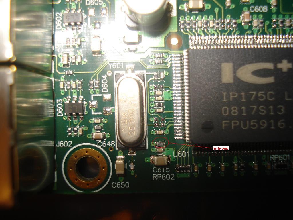

What’s happen with all 3 ethernet port? If you don’t have link on any port but RouterOS show link on all three ports - it’s simple hardware problem and can be fixed in few seconds.
aaa,
“it’s simple hardware problem and can be fixed in few seconds.”
How?
I note that some RB433 without visible reasons lost all three ethernet port connection but in RouterOS I see link connected on all three ports. I find that one ferrite bead lost resistance - see picture in attach.Check resistance before with multimeter and if it is not close to 0 ohms solder tiny wire in parallel this part.
This fix help only on this case and not solution for any lightening damage.
Tried that and its close to 0 ohms. I have a feeling that the bios is corrupt!
