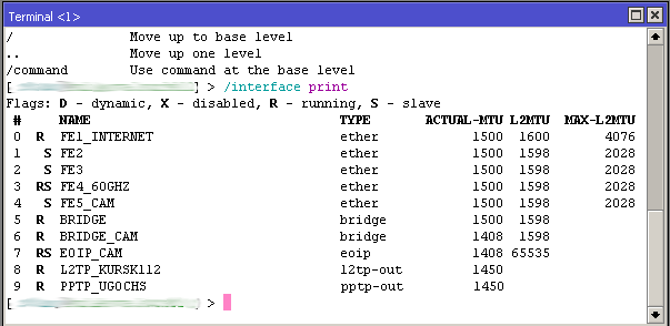

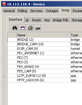

Numbering does not match.
The UI interface index is not the same, see what you get from /interface print oid - the final octet of the OIDs are the SNMP interface index.
0 R name=.1.3.6.1.2.1.2.2.1.2.1
1 S name=.1.3.6.1.2.1.2.2.1.2.7
2 S name=.1.3.6.1.2.1.2.2.1.2.3
3 RS name=.1.3.6.1.2.1.2.2.1.2.4
4 S name=.1.3.6.1.2.1.2.2.1.2.5
5 R name=.1.3.6.1.2.1.2.2.1.2.2
6 R name=.1.3.6.1.2.1.2.2.1.2.10
7 RS name=.1.3.6.1.2.1.2.2.1.2.9
8 R name=.1.3.6.1.2.1.2.2.1.2.8
9 R name=.1.3.6.1.2.1.2.2.1.2.6
Can this be changed?
No directly. As mentioned before Mikrotik builds an index whilst enumerating interfaces - each new interface is assigned a sequentially increasing value which does not change.
It is odd that the ethernet interfaces are not sequential as they would be discovered after a factory reset and cannot be removed via the UI, for example:
RB750Gr2 ifIndex 1-5=ether1-5
RB850Gx2 ifIndex 1-5=ether1-5
RB960PGS ifIndex 1-5=ether1-5, 6=sfp1
RB3011UiAS ifIndex 1-5=ether1-5, 6=sfp1, 7-11=ether6-10
