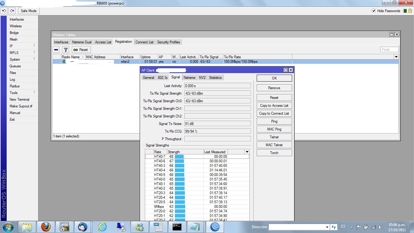

Hi, does anyone seen that the ptroughput is missing when you configure, nv2-nstreme or nv2 only mode?
I´m using two RB600 with Ros v5.7 and SR71-15. Everithing seems to be right but the ptroughput.

Try this…
set wlanX wireless-protocol=nv2
Where wlanX should be replaced by your interface number, then I disabled the nstreme protocol y the nstreme tab in winbox. With this option set on the ap side, only nv2 clients can connect to the AP, yo should also set the distance between the 2 points in the cell parameter under nv2 configuration. You should set the same on the client, but you cant edit the nv2 parameters on that side of the link.
Hope this helps you!.
