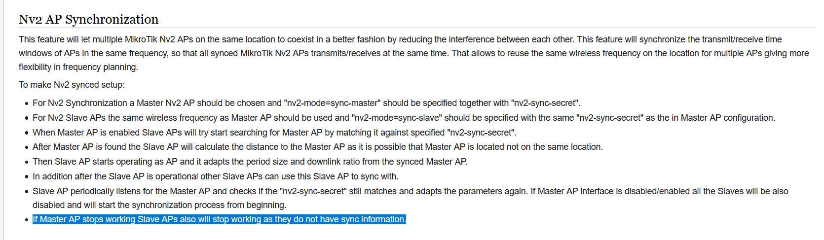

Nv2 AP Synchronization
Could anyone elaborate on the below sentence found in the mikrotik WIKI concerning Nv2 AP Synchronization?
(If Master AP stops working Slave APs also will stop working as they do not have sync information.)
Does that mean that all APs in sync will stop working completely and customers will lose access or just the sync feature which will stop?
Thanks in advance
YES
