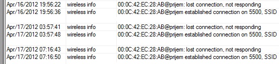

I have generated supout.rif after disconnect with 5.15rc1(12.April) and still disconnect.
yes, I have the same error logs :frowning:
