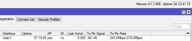

NV2 Disconnections continues in version 5.6
After 3 days lost the connection again.
Supout file was sent to the support.
Ticket#2011080966000281
Dzieva.

I decreases 5db in tx power and continued the same problem.
anyway thanks
Dzieva
if you are not able to resolve lowering the power, you have to switch to a single chain.
Using single chain with very high signal (around -5x) is the only way to workaround disconnection at the moment using 802.11N in nstreme and nv2.
regards
Ros

Hi Rpingar,
Thanks for this, switch to a single chain solved the problem.
No more disconnections.
Thanks very much
Dzieva
