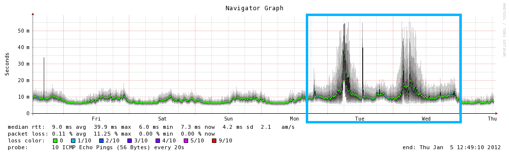

nv2 dual chain latency
Is this normal?
Rb711G - h+V feeder, 120cm prime focus dish.
When i enable both tx chains, the latency gets bigger. Is this normal?
I too have some links with high latency but only if there is no trafic, over 20mbps.
I’ve given up on using dual-chains with Mikrotik. Even with the SXT, today I installed a PtP. Both Chains = 80 x 206 Mbps. One Chain = 150x150Mbps, 100% CCQ.
Only way around it, is to use NV2, but then you have increased latency. I’ll stick with single-chain Nstreme for now.
i am using nv2 with mpls/vpls
hi wispwest,
have u tested real throughput with single n dual chains.
even with ccq around 60% i have got 100 mbps actual. so it does not always help to have 100%ccq.
i am talking with nv2. n i have seen ccq increase when bandwidth utilisation increases with nv2.
when thr is no load my ccq is 10/12%.
maybe interference problem?
the two chains interfering one with the other?
