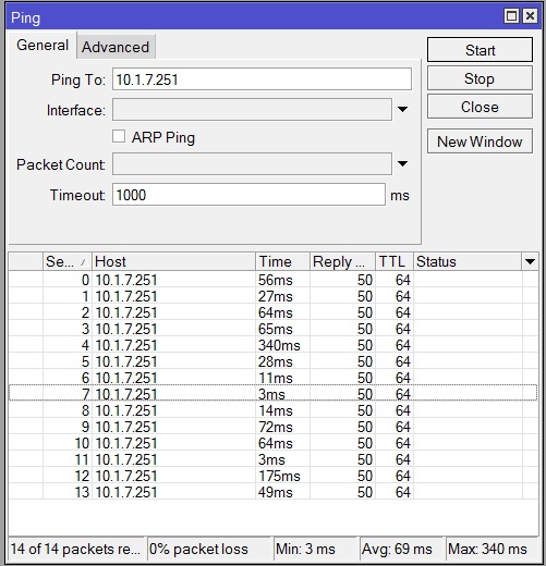

The way NV2 Works is entirely different than Nstreme/802.11
Under the TDMA settings, any client that is not actively participating in traffic, will see longer ping times. I believe it is because the ap has a longer inital poll time for traffic, though this same
phenomenon happens under PTP NV2 links as well.

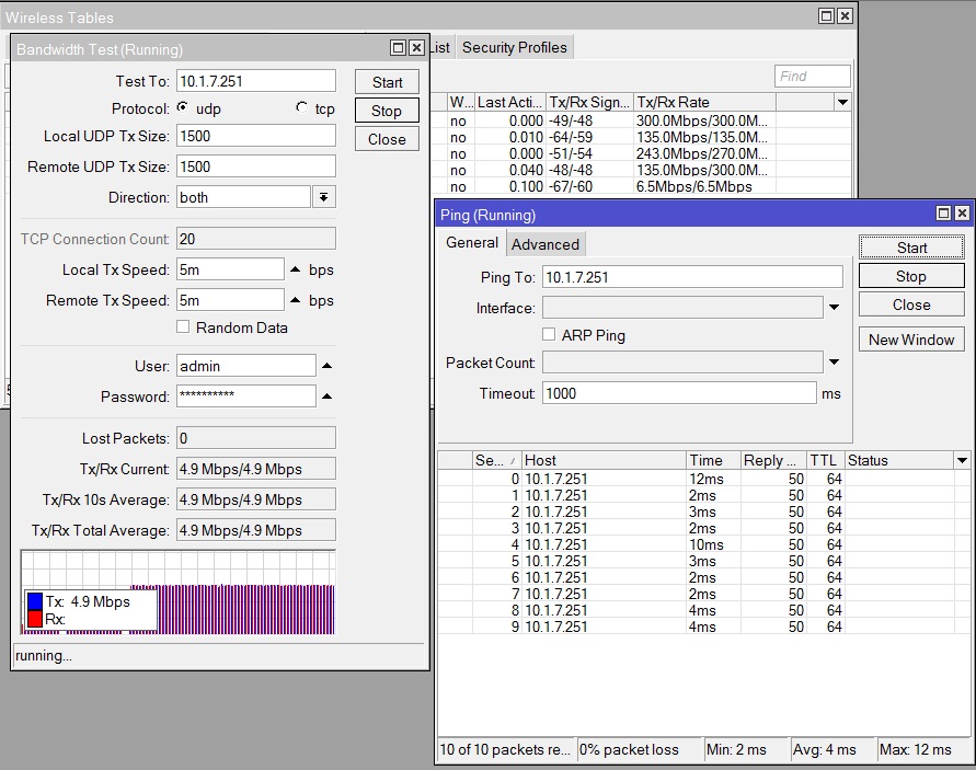

Do this:
Do a bandwidth test over the link, but limit the TX and RX speed to say… 5 Megabits send and recieve,
and then do your ping tests.
Also try a real world response test over the link to see your real packet transmit times.
http://myspeed.visualware.com/indexvoip.php
There is a excellent voip test. it will test your jitter ping and packet loss with small packets and you can see your actual times out to a destination.
You will notice than when your link is under load, your static ping times will show the actual latency of the link, rather than just some arbitrary number as it is prone to do under no load.
I’ll share an example: First picture is the link under load, the second (bottom) picture is a link under NO load.
