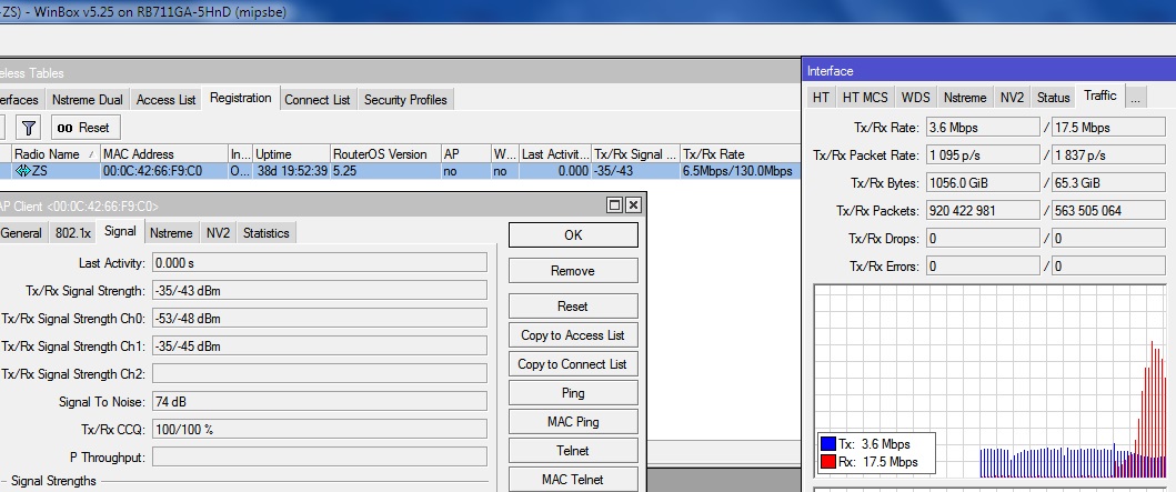

Hello. NV2 have still random problems with locked modulation on 6,5Mbit. This is P2P link. On both sides is ROS 5.25
AP side show 6,5Mbit TX / 130 Mbit RX. In the same time client side of the link show 130/130Mbit.
Sometimes it happens after 30 days, sometimes after 80 days. It’s completely random. Throughput is very poor because of the locked modulation :frowning:
See Ticket # 2012122166000702
I think so this is problem on AP side. Just turn off/on wireless and everything is ok - 130/130Mbit
Users - how do you solve this problem?

See BW test over wlan interface. Maximum troughput in tx is about 5Mbit. It is simple TX is locked to 6,5Mbit, but why? You don´t have sometimes this problem?
Disable/enable wireless, then is rate 130/130 a troughput in tx is over 60Mbit. This problem is only with NV2 protocol

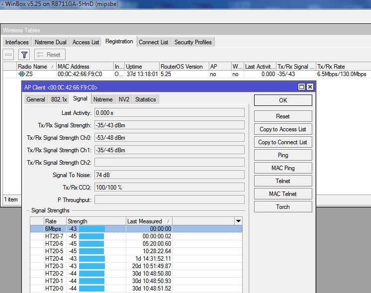

Typical signs of the problems is that latency on the link raises (but it depends on traffic on the radios) and the throghput lowers and when you try to find out what happened you see that AP is showing some low modulation in TX direction to a station. And the modulation doesn’t change during time. Usually you will see a low modulation like 6.5mbps and even there is a good quality the modulation is still the same. Client side in the same time will show RX modulation which is different (higher). If you check times of RX modulation last measurement showed by client (winbox’s Signal Strengths or print stats in registration-table) the there is only one or 2 modulations with lower times (measured recently). If these modulations are low ones you have a problem.
It is possible to write a script which will check all the client stations and inspect the modulation table’s times (btw: thank you MT for the stupid time representation used in CLI)
And it looks like any modulation can be the locked one (we have seen already locks on 6,9,12,18,36). The lower ones have higher impact on the network. Btw MT shows another modulation name in ‘Signal strengths’ and in the registration table (6 versus 6.5 etc).

the rates on CPE (shown in Registration Tab) are higher than the corresponding ones on AP (usually there is maximum rate displayed). Typically you can find that a ‘locked’ CPE shows 100% quality in RX direction (probably because it gets all the packets on very low modulation) and when you have “Last Measured” of modulations ordered by their time you see only one modulation (typically basic modulation i.e 6mbps) or two modulations which were measured before very short time but and all other modulation were measured deep in the past (I use 5 minutes as a threshold in the script).
On the AP you can identify ‘locked’ station when you check all the stations with low TX modulation - run (MAC) ping to them with delay 100ms and wait a minute if the TX modulation goes higher. If it remains the same (and the TX quality is not poor) the station has probably locked modulation. Then kick it off - seelct it and press the “-” (minus) button near to the top left corner of the Registration Tab window). After the station reconnects check if the modulation goes higher.
