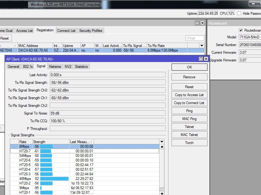

Now with uptime only 22days. P2P link is locked to 6,5Mbit. Customers call - speed is terrible :confused:
note: you need inspect Last Measured times on client not on AP
Yes but what is solution? In configuration P2P links is problem on AP side. Disable/enable wireless solve this problem.
When you have locked clients - what is solution? Reboot (Disable/enable) AP or just reboot client?
to ‘unlock’ the client it is enough to disconnect it. Use the [-] (the minus) button in Registration table in winbox (either on AP or on client). This way the client reconnects in shortest time probably.

Just an idea because 6Mbps seems to be listed as an 802.11a/b/g rate, not an 802.11n-like HT rate. Also, I’ve removed all the a/b/g rates from a client/AP pair and the 6Mbps rate is still listed in “/int wire reg print stats”. This might suggest that if you’re only looking at the “Signal Stengths” table then the “6Mbps” won’t ever go away… Maybe MikroTik can confirm that the 6Mbps rate is tested for signal strength regardless of your data rate settings?
Along the same theme, if your link ‘usually’ has a data rate of 130Mbps, with a high CCQ, then why not use “rate-set=configured” and explicitly limit your data rate choices to HT20-7 or HT40-3 or whatever. Maybe that will stop RouterOS from even picking the 6.5Mbit rate? (By the way, 6.5Mbps is HT20-0, not the 6Mbps a/b/g rate in case there is any confusion)
I have two test OmniTiks running NV2 locked to mcs-11 (ht20-3 and ht40-3) and although the 6Mbps rate shows up in signal strengths, the actual tx/rx rates are both 120Mbps:
