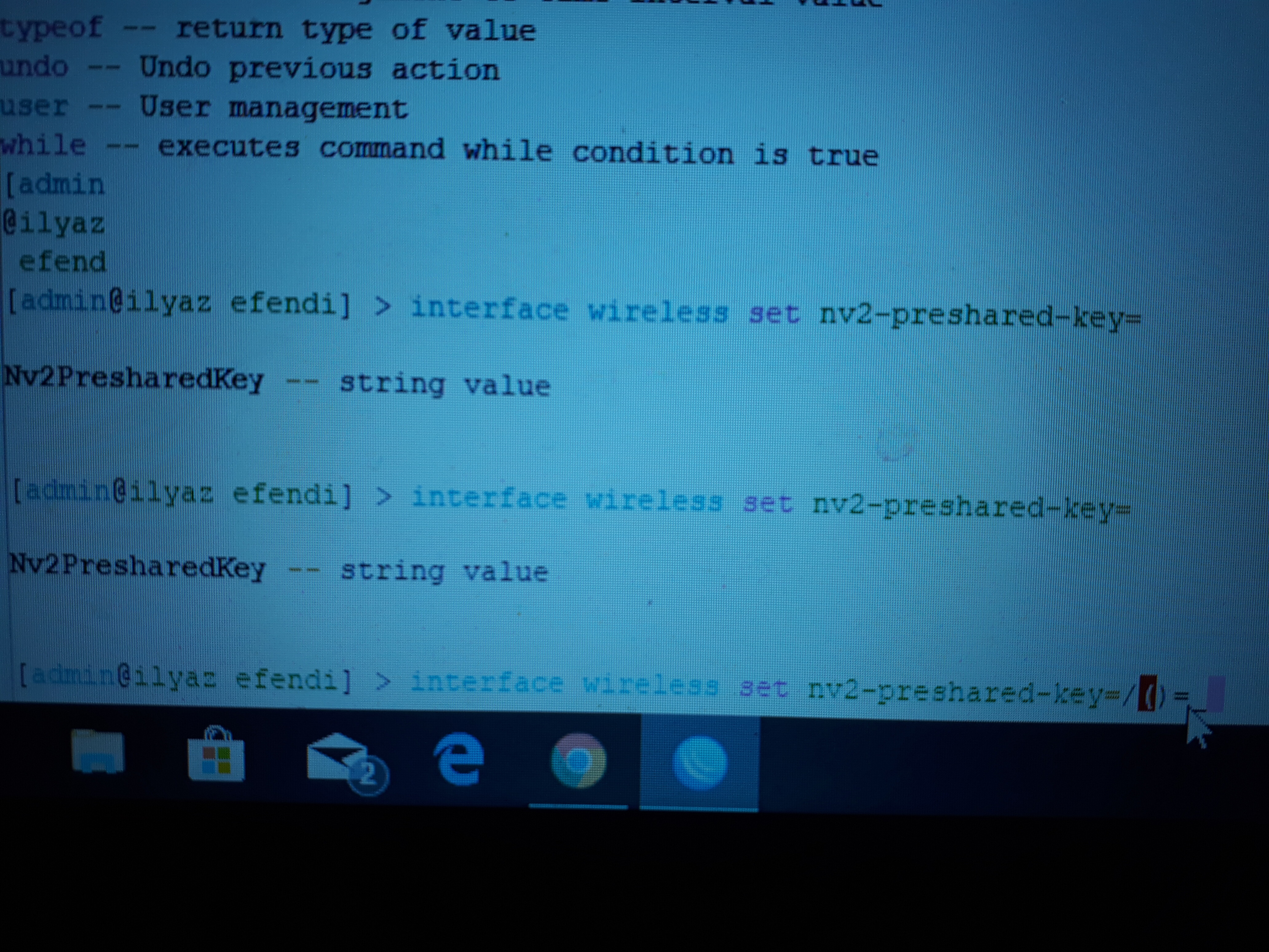

Nv2 presharedkey -- string value
i dont know ,why i can not write question martk “?” here. I get this message “Nv2PresharedKey – string value” i want to use question mark in my nv2-preshared-key.
The value of string has to be inside quotation marks and add "" before the special symbol, like
interface wireless set nv2-preshared-key="\?testkey"
If you have problems with other symbols, check https://wiki.mikrotik.com/wiki/Manual:Scripting#Constant_Escape_Sequences
yess :slight_smile: thnks, its working.
