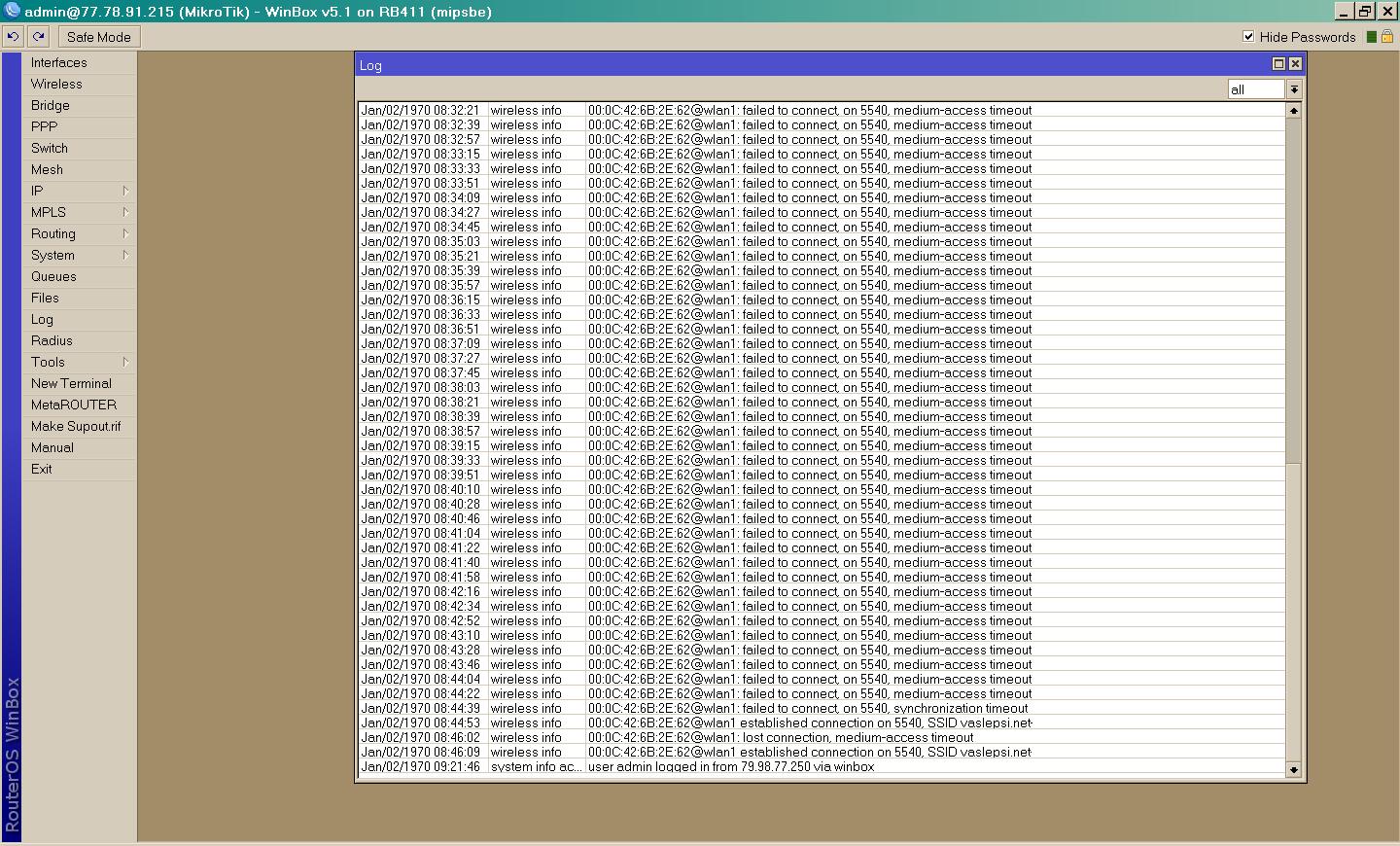

LOG from one client: Screenshot (all clients have the same log information)

You have very old version.
Upgrade AP and all clients to 5.24 which solve this problem

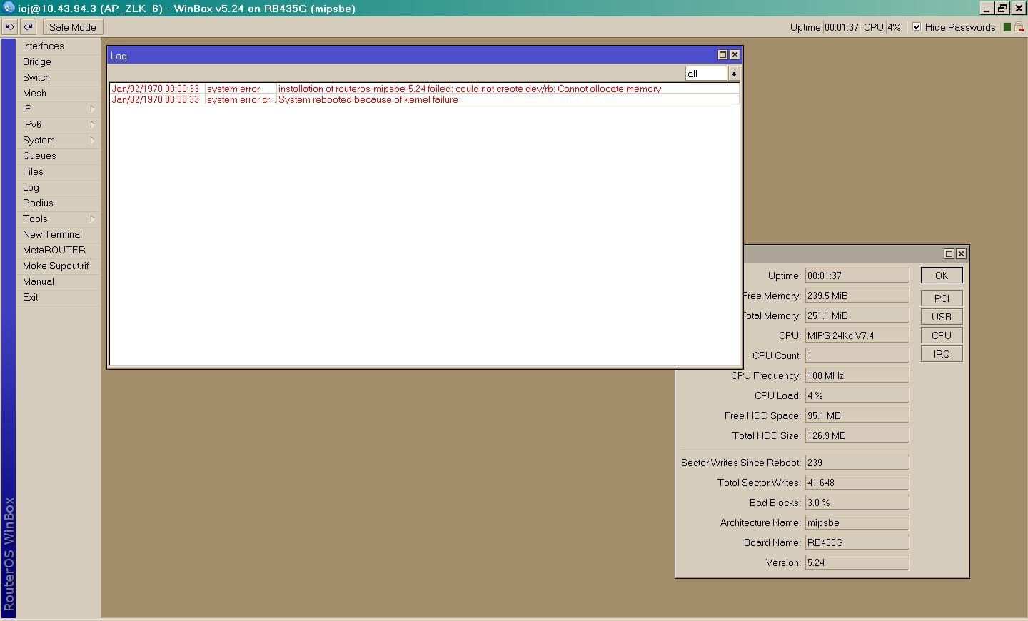

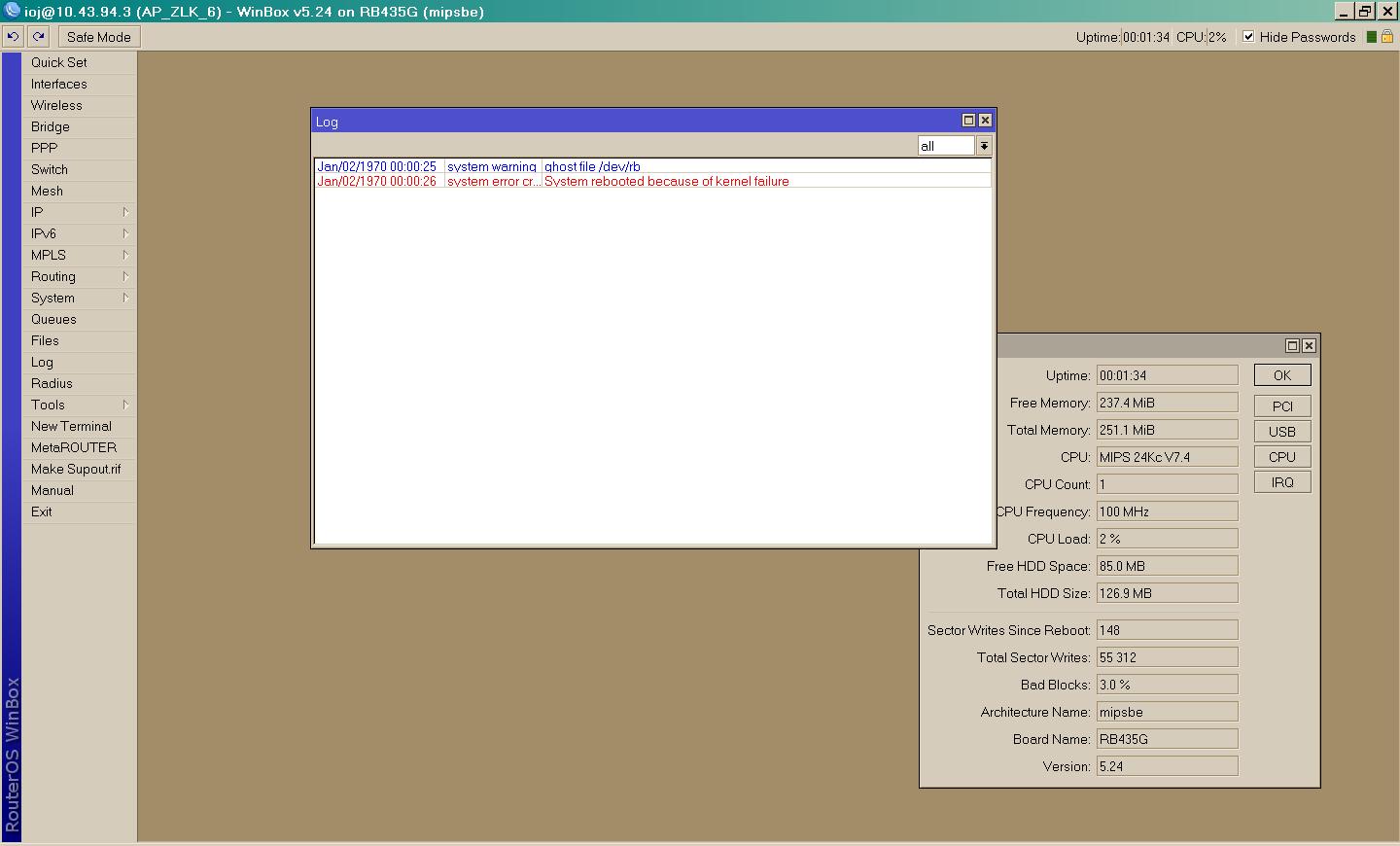

Here is a update story :
Your CPU is downgraded to 100Mhz. It is failure.
Set cpu to 680Mhz by command:
/system routerboard settings set cpu-frequency=680Mhz
/system routerboard upgrade
/system reboot
also make sure that you upgrade the Clients as well to v5.24.
