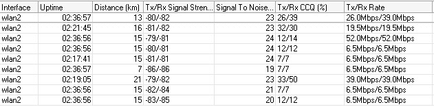

We’ve set a PtMP implementation with a centralized AP (433UAH) and 9 SXT clients connected on APs sector antenna.
Antenna is dual polarized (HV). Below you may find a screenshot with distances and respective SNR values.
The majority of the SXTs are located at 15km distance from sector antenna.
Each individual SXT at 15km distance gains 20mbps using bandwith test tool.
However the problem is when simultaneous traffic come from parallel SXT sessions, AP wireless interface (wlan2) cannot serve more than 10-12 mbps in total… :frowning: Very, very dissapointing…

Your signals are extremely low. You should not exceed -75. This is the reason of your problem.
Someone needs to learn what signal levels stand for, and also what connection speeds represent.
You have major issues on your network. you’re lucky you are getting as much speed as you are.
Every poorly connected client slows your entire access point down. if you want better speeds, the answer is simple:
You must increase signal strength overall.
All your clients need a minimum of -75db to achieve decent overall speeds. Also, you need to address the client that has -86 db, that unit alone will kill your
bandwidth.
-Brad

Next step is to find a closer position to shorten distance between AP and the SXTs in order to achieve better overall signals.
Sector antenna gain is 19dbi (MIMO) and SXT antenna gain is 16dbi, thus from your experience which is the optimum distance for signals -75 or better? (I mean worst case scenario for distance).

What we noticed is that when the single sxt with the reflector is the only device device associated to the AP, speed test tool reaches up to 80mbps, but when all rest SXTs associated to the AP speed throughput drops at 20mbps…
So, I assume there is some kind of dependency here with the rest associated clients…
I’ve concluded that AP change position is one way solution for our case in order to gain overall better signals. :confused: … and I’m now trying to find this new closer position… :frowning:
