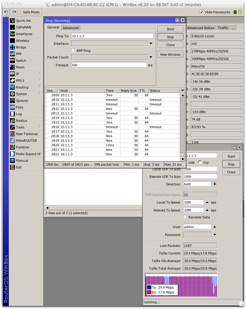

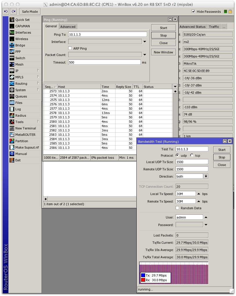

CPE1 and CPE2 look like this, running a 30mbps bandwidth test and 500ms ping:

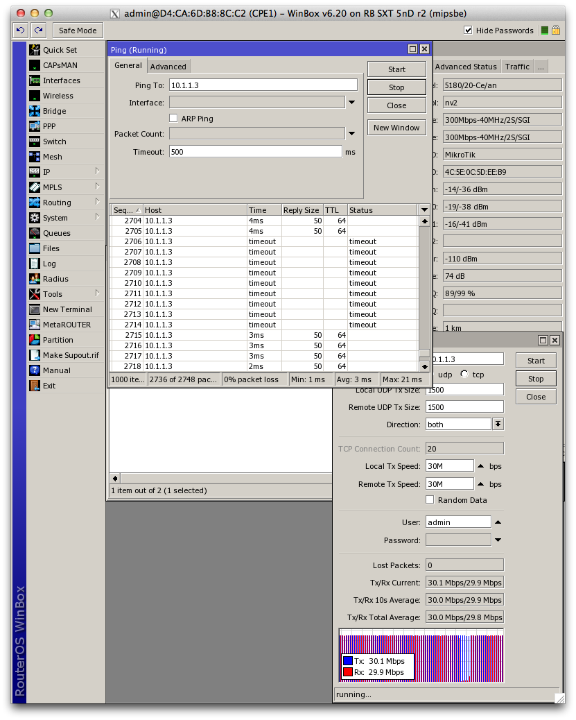

When I disconnect CPE2, CPE1 sees a lot of packet loss (but stays associated) and then recovers after about 5 seconds.
When I reconnect CPE2 again, CPE1 against sees a lot of packet loss (but stays associated) and recovers gradually over a few seconds.
