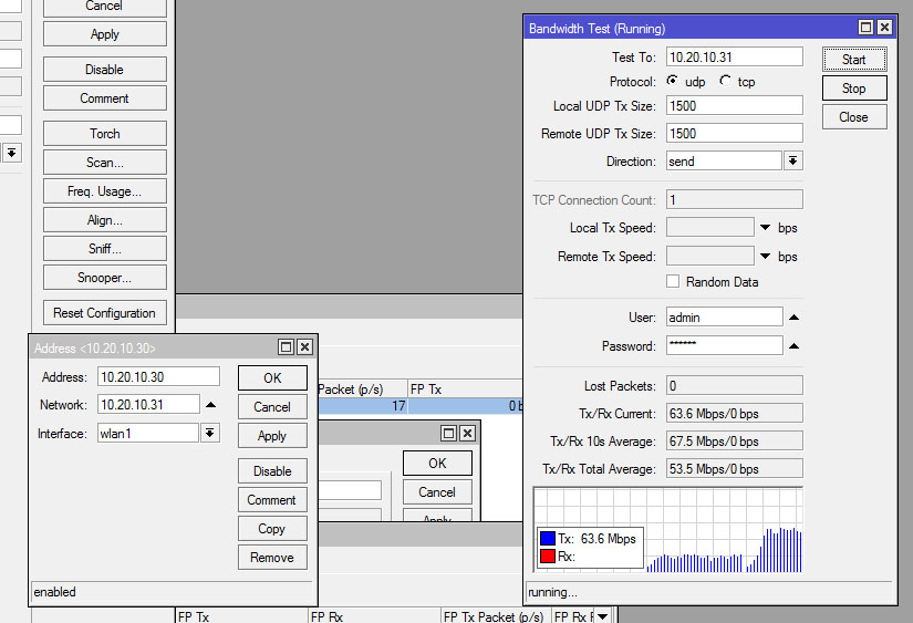

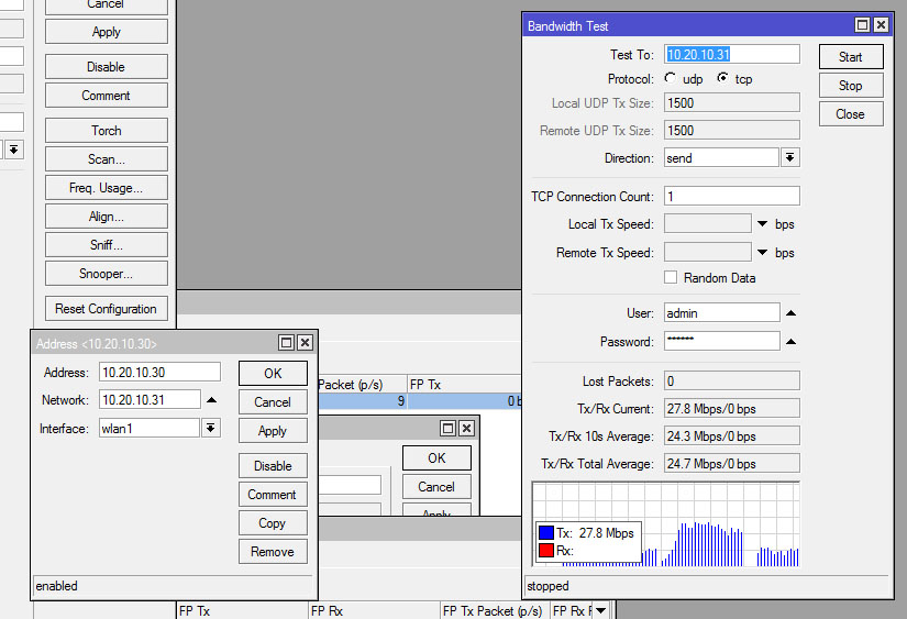

I am experiencing low bandwidth test from a single tcp connection over nv2 protocol. This problem is not present over nstream protocol. since nstream has some disconnecting problems i have preferred using nv2. Or should i not use nv2 and nstream at all? i seen many posts in the past about this but not any solution so far. nv2 protocol dosent let u any option for tuning. even when i change the tdma timing offset option on the nv2 section of the ap wireless interface it hasn’t any effect on the connection. i am using wds.

Yes i just tried now with station bridge and its the same result.
I switched already another ap to nstreme with some tweaking and is working a lot better. even though other antennas connected to it disconnect sometimes, throughput is a lot better compared to nv2. nv2 seem to be a disaster on point to multi point maybe in noisy environments.

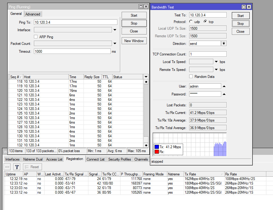

  2. Distances are variable for different stations but in the pictures below there are 4 sxt connected to a omnitik. 3 of them 300m away and one about 800m.

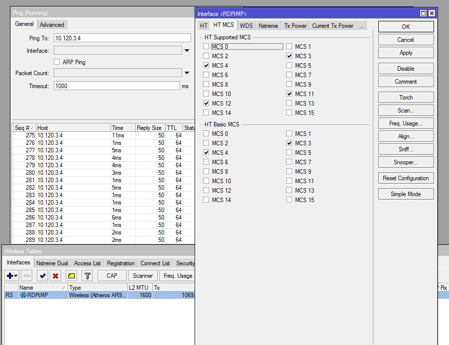

After reading other topics and mikrotik manual and wiki i tried a couple of things trying to achieve maximum performance and stability without disconnecting. Nstreme pooling and csma disabled.
  1. Tried rising the noise floor threshold until i got good Tx rate and stability. Rising noise floor threshold too much will result in poor rate selection because of lower SNR. I set noise floor threshold to -103 in this location.
  2. Tried various of other options in advanced wireless interface settings like hw retries, disconnect timeout and on fail retry but none of them did help with disconnection issue. After searching more online and in other topics read that mikrotik work better on QAM16 modulation. First i tried wireless N only but sxt keept disconnecting randomly from registration table with not pooled for too long message in log. Then i selected only QAM16 in suported rates and maybe resolved the disconnecting issue. since sxt uptime is more than 12h now.
Dont want to arrive at a conclusion too fast but maybe nstreme disconnects on modulation different of QAM16 or just when modulation is swiched.
Now i have 30-40 M on single tcp connection while on Nv2 was 5-7 M and from node to node with active traffic was even worse.
