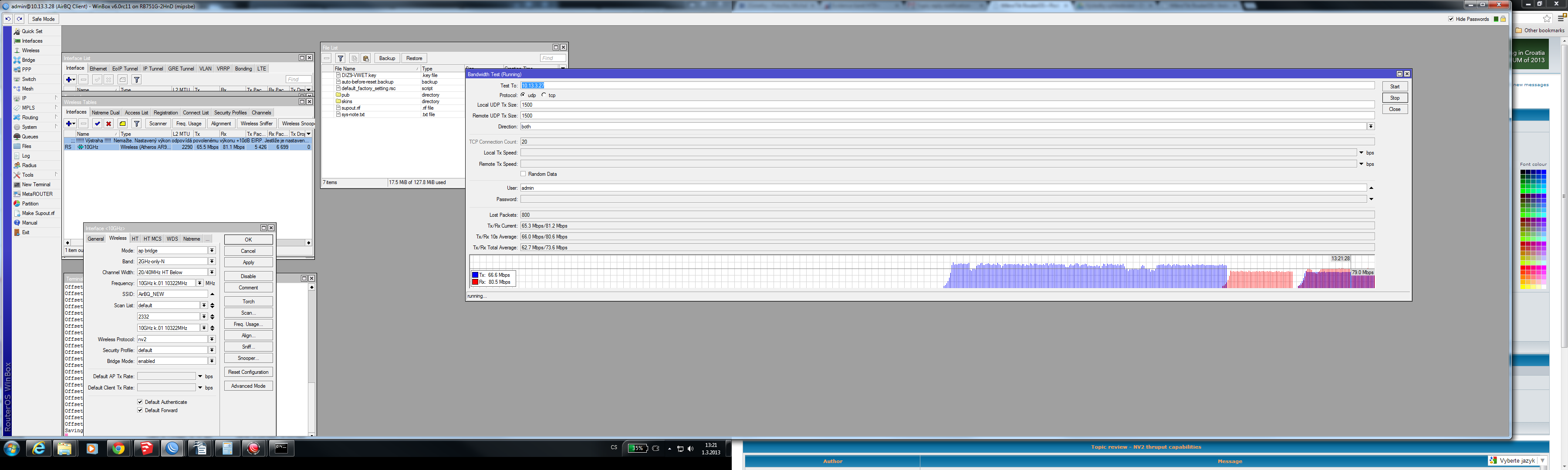

OK, I got a bit more time today.. It is not matter not only of 28MHz channel, but some disproportion you can see even on 40MHz channel already , where with 40MHz channel I am getting not 230 Mbit of thruput as normally on 5,23ROS, but “only” 180Mbit, but it is clearly visible on 28MHz channel that it is actually only 2/3 of possible load.. On pic you can see TX, then RX test, then both ways. You can clearly see that both was makes together more than 1 way.. The link speed is 182,5Mbit
I am sending you supout as well..
