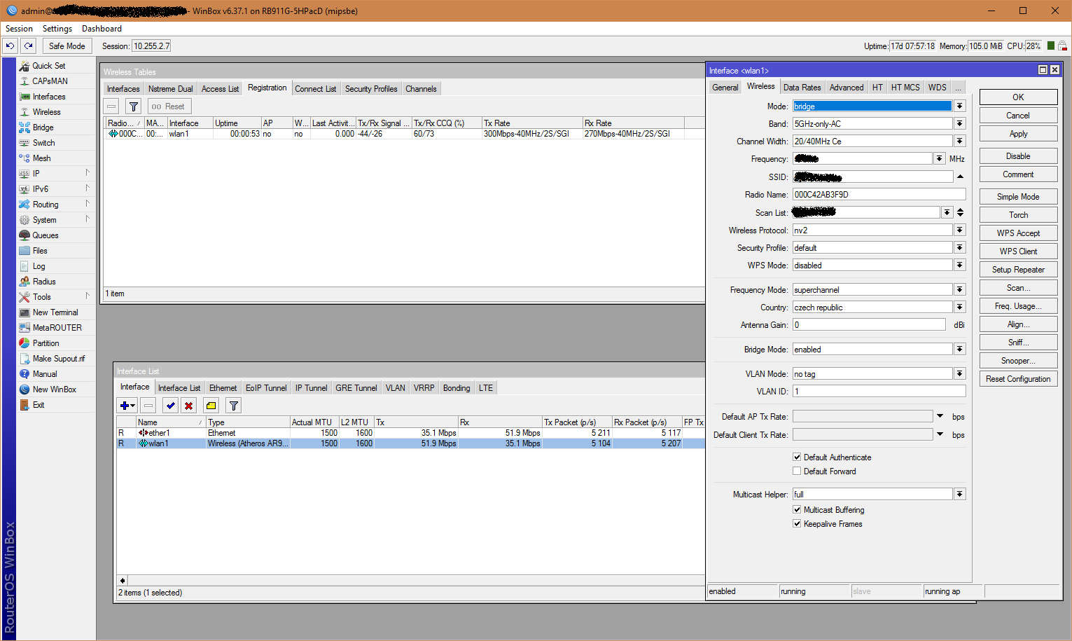

I have a PtP connection and when switching between NV2 and NSTREME is an extreme difference in transmission speed and quality link (CCQ). Is it an explanation? A few years ago it was with wireless protocol on the contrary. Today it’s like. So everywhere we recently set NSTREME because NV2 is worse. Where is the problem? It’s not only one PtP connection where the problem is.
nstreme is ok:
nv2 is not ok:
same frequency, same setting, same place. Switch nstreme to nv2 (TDMA 2ms or auto… no difference) only. Repeatable.
