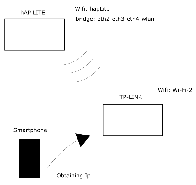

Hi, I have got an hAP Lite, eth2, eth3, eth4 and wlan are in bridge mode, it works fine, but the problem is with tp-link repeater. When I power on the tp-link, obtains an ip from mikrotik dhcp server, but when I try connect to tp-link, my smartphone still “obtaining ip”.
At dhcp server → leases, I can see the mac address of my smartphone and the status is “offered”.
I researched here, in other post about this problem, but I can’t resolve my problem with mikrotik and tp-link. This is my schema:

Most likely TP link drops DHCP offers
The connection of your tp link and mikrotik is via wireless? If yes, try to connect that via wired and test if your cp can now able to obtain an IP from the tplink.
Sorry for delay.
The connection between Mikrotik and tp-link is via wireless. With wired it works fine, the problem is only with wlan interface.
I said, my mikrotik has eth2, eth3, eth4 and wlan in bridge.
I readed in other posts, a solution is leave without bridge wlan. So now I have bridge from eth2 to eth4, but without bridge in wlan.
Then I tried connect tp-link to wlan, but it wasn’t succefull. Again the wi fi shows “obtaining ip”, at the dhcp server → leases, appears the ip of tp-link with state “bound” and appears the ip of my device with its ip and state “offered”.
So, I don’t understand why is impossible connect tp-link to mikrotik via wireless.
Are there any configuration bad/broken/incorrect in my mikrotik?
As I mentioned TP link is blocking offers, no configuration change on MT router will change that. You can verify that MT sends out offer to each request by looking at DHCP logs or packet sniffer.
Yes, I saw, mikrotik sends for each request.
Now I changed the firmware of tp-link to gargoyle firmware, and again I tried to configure in repeater or bridge mode but the problem is same.
So, if the problem appears with different tp-link (701nd and 743nd) and different firmware (factory default and gargoyle firmware). Although mikrotik shows that he is sending out offers by each request, I think, the problem is at mikrotik, in dhcp server or maybe in wlan.
I can’t think of another configuration I can try.
Could it be that settings of tp-link and RB’s wireless are not compatible? WiFi “repeating” is not a straight-forward business. Search around forum and see if you can make something out of different WAP settings (ap VS ap-bridge VS bridge and how does WPS come into play).
Well, I tried with different firmware, ie gargoyle, open-wrt and dd-wrt. But none has worked. So I think the unique way is try with other mikrotik.
Perhaps the mac address is translated somehow in the repeating process. Could you try with ‘always broadcast’ either on or off in the MT dhcp server configuration?
Can you do packet captures, one of the dhcp acquisition directly connected to the MT and one via the repeater and compare them?
