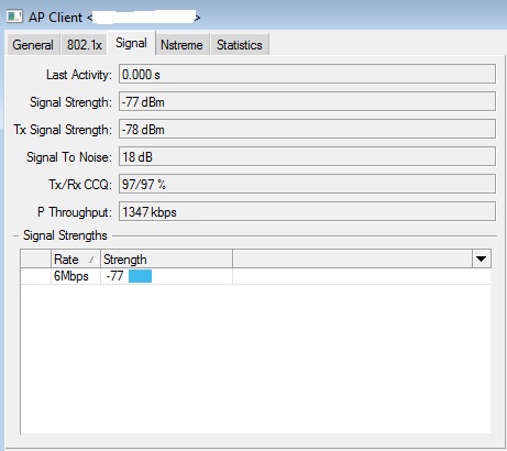

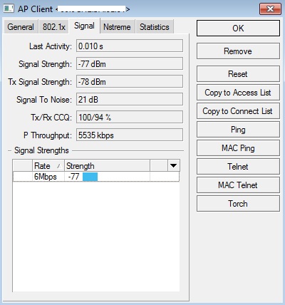

AP:
Client:
Bandwidth:
We have had to limit the connection to 6mbps/6mbps to try keep it stable so clietns can atleast use it, we also have tried with and without nstream and had to keep nstream on due to it barley passing 1mbps without it.
