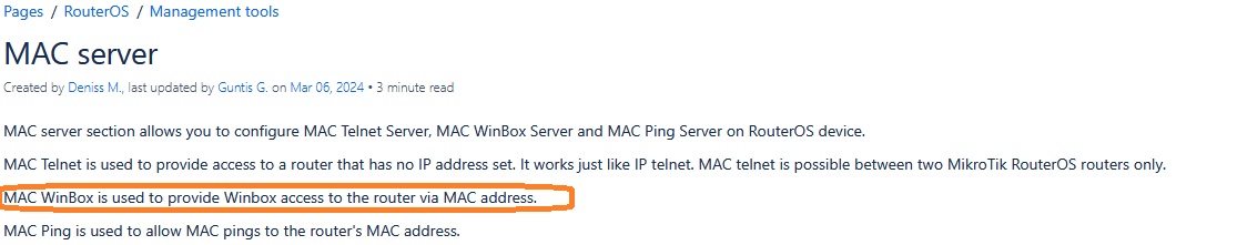

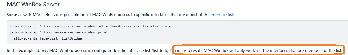

quote:" I will say that you did make me realize that it would be wise to enable MAC WINBOX on those offbridge ports. That appears to require adding the OffBridge port to the admin/management/trusted/manage interface list (and making sure that MAC WINBOX is enabled for that interface list)." unquote.
I am still not convinced that you realize that RoS is based on logic and rules and not black magic??
In other words, one has to be at least a little curious, at least a little self-motivated, and do some basic research/education vice praying that it works. :slight_smile:
