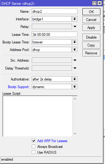

Use for your guest network bootp support = dynamic and choose arp for Add ARP For a Leases
Could you please explain what does this do?
In any case - I’ve simplified my example a bit. In reality we have multiple subnets which need protection, and I would like to have one single rule without needing to remember to update it if we add another subnet. Is that possible? Like dropping everything from one wlan interface to another.
