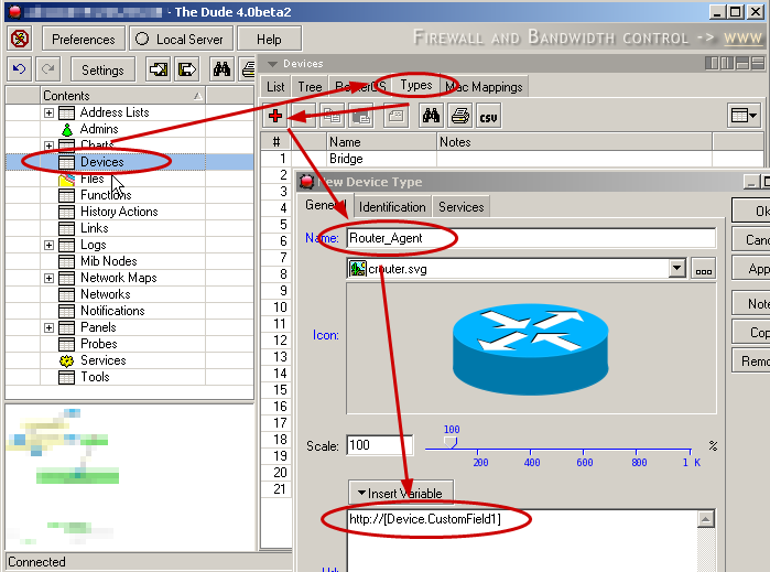

Hello.
Do not make it to complex. Yes it is possible to write many functions and so on…
But, in your case the solution should be

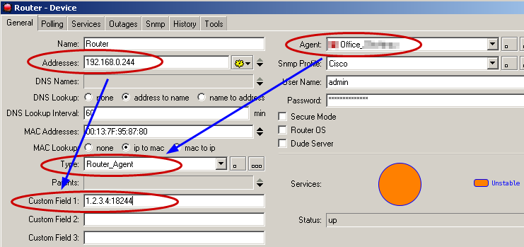

Thanks for the suggestion. I made a slight modification to your suggestion, and simply made another tool which browses to http://[Device.CustomField1]/ for now.
The thing is - we have hundreds and hundreds of devices, and I would like to avoid having to manually populate CustomField1 with this info every time a device is added.
Is there an OID that returns the IP of the Agent that is responsible for a device? My goal is to have as much of the features be added automatically as possible, given the devices are properly configured out in the field.
