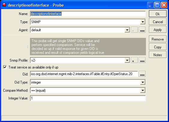

Oh hmm I have not done this exactly :frowning: I must be mistaken but I think there is a solution.
The only way I was able to track the status of an interface was to SNMPwalk the device and create a probe that tracked the operational status.
This is not the greatest solution but it works. Just give it the same name as the description on the interface.
I tried to create a function based probe that would give an error but that didn’t work.

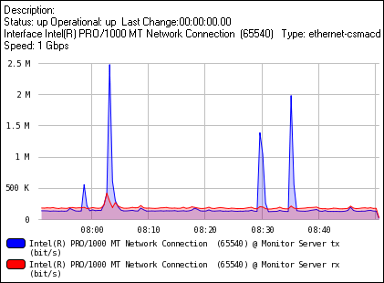

Not that this helps but here is a screen shot of my server utilization on a Gigabit Ethernet…
Maybe we can find out if a certain amount of traffic is above the time sensitive processing requirements?
