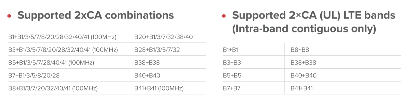

The main difference between LTE6 and LTE7 is on supported CAs:
I have no information on R11eL-FG621-EA, but for example
R11-LTE6
R11-LTE7

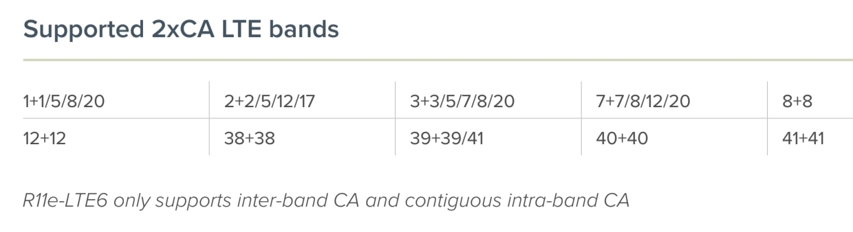

Yes, the FG621-EA has fewer options for aggregating different bands
( https://cdn.mikrotik.com/web-assets/product_files/SXT_LTE6_kit_240409.pdf ) :
