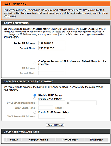

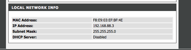

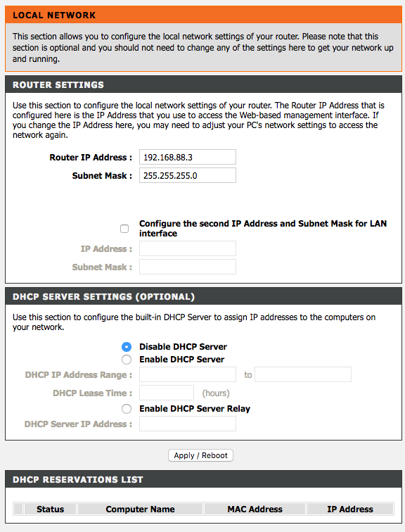

I have an old d-link router that i have setup as an access point. I have assigned it a static IP of 192.168.88.3 and have set its DNS to that of the mikrotik (192.168.88.1). I have also switched the DHCP server off on the d-link router. I have then connected it to the mikrotik via ethernet.

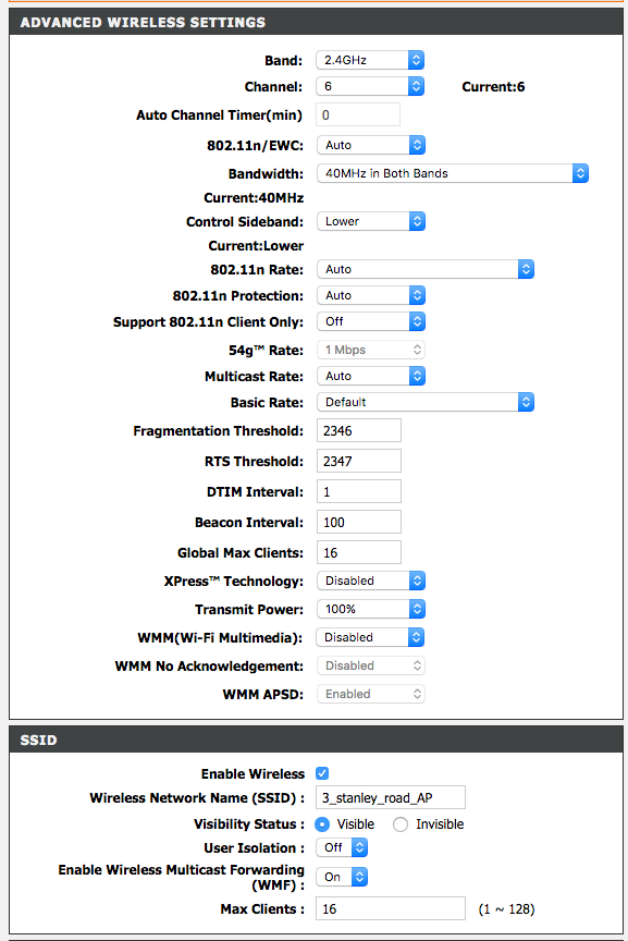

One more pic
For this setup to work, the Dlink should transparently bridge its wlan interface to its ether ports (in the same way you bridged the mikrotik ether master port + wlan interface), and it seems this is not the case, or at least isn’t that transparent. That’s why wired connections on the dlink don’t have problems getting DHCP from the mikrotik, while wireless do.
Try investigating that d-link specific issue.
