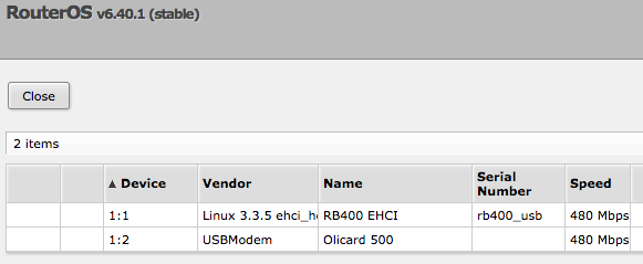

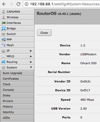

Got one of this Olivetti Olicard 500 4G USB Modem that is not working with my RB951ui-2hnd
It’s listed in System/Resources/USB

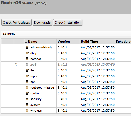

I have the LTE package installed properly

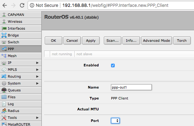

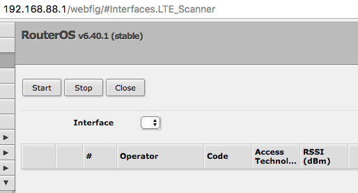

But it doesn’t show on interfaces
Any ideas on how to configure this modem ?

[attachment=0]Screen Shot 2017-08-05 at 14.10.13.png[/attachment]
1 device=“1:2” vendor=“USBModem” name=“Olicard 500” vendor-id=“0x0b3c” device-id=“0xf017” speed=“480 Mbps” ports=0 usb-version=“2.00”

Problem is that the device is not even recognized as a valid interface (port)
As you can see “Port” is empty
