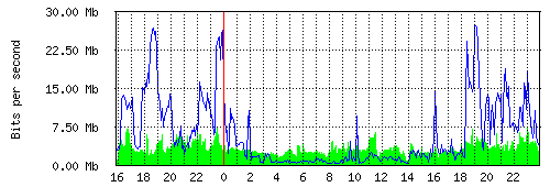

10-15 costumers per OmniTik
I see clients downloading with 35-40mbits
when I do btest it can go +70mbits with nv2
This is today daily graph from one of my OmniTik
