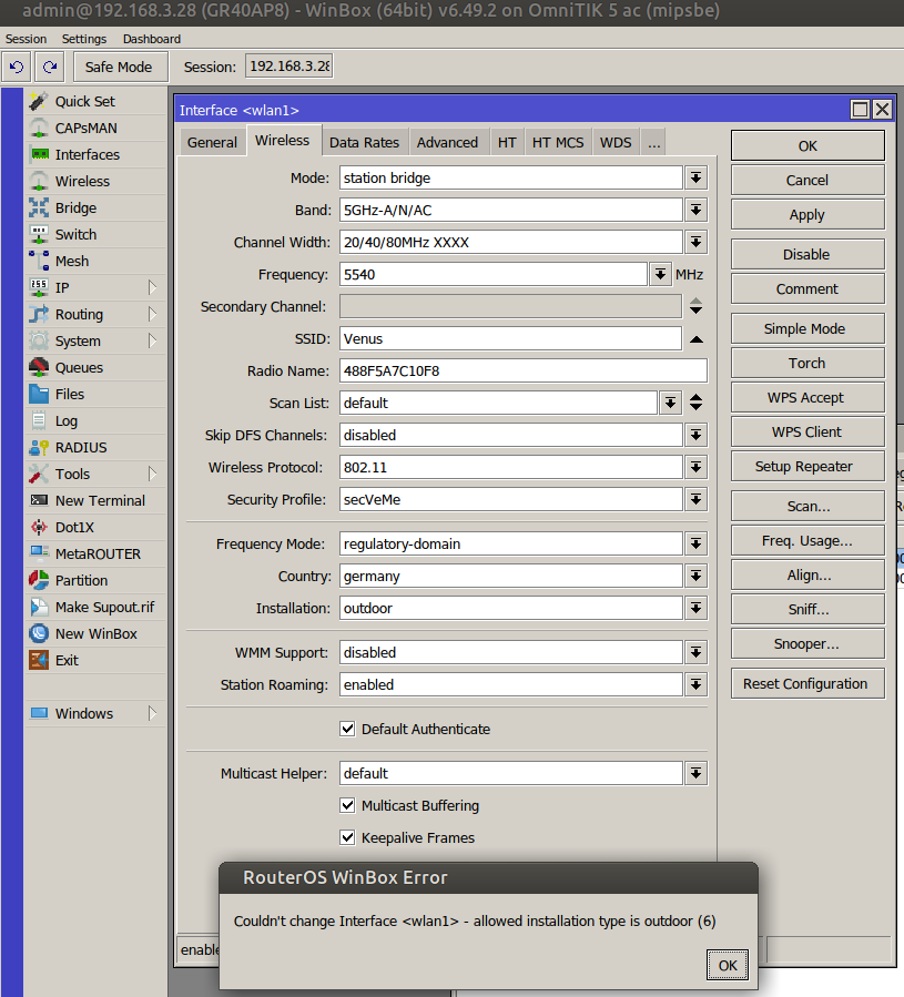

I can’t switch my OmniTIK 5ac (ROS 6.49.2) to “indoor” Installation.
In words:
[admin@GR40AP8] /interface wireless> set installation=indoor wlan1
failure: allowed installation type is outdoor
This is just strange to me. I would like to use a lower frequency range like 5180 MHz to support further devices that can’t connect to the current high channel frequency.

I am puzzled as I can’t find a parameter that prevents the switch to indoor installation.
Any idea??
BR
Uwe
This device is designed and certified for outdoor usage. Indoor freq are prohibited outdoor. The device is locked on outdoor usage, there is no parameter we can set to change this. Changing this would invalidate the ETSI or CE certification. (Just reminder: Outdoor freq are not prohibited by law for use indoor)
If you are using it indoor, you will have to cheat on the country, to be able to use indoor freq. (5180-5320).
Cheating is illegal !? Maybe. But this is not in conflict with legal RF usage, when you are using it indoor and limit the TXpower to the indoor legal values for Germany. ((23 and 20 dBm) - 6dBi antenna gain.)

Ah yes, I didn’t think about the certification, although being aware of the legal limitation.
That makes perfect sense, kind of legal enforcement. I will have a look at your suggested work around.
Thank you very much for the swift reply!

@anav: regulatory domain Canada for the Omnitik outdoor-only device allows the ETSI indoor freq as outdoor freq at a lower (23dBm) TXpower (that cannot be used at all if an ETSI/Europe country is choosen in Omnitik). That lower TX-power is the same as the ETSI TXpower indoor.
You can ‘skip’ the DFS freq, not disable DFS functionality. Again ETSI countries have nothing in the allowed outdoor freq list if DFS is skipped. All freq are DFS only.
FCC (US and Canada) still have the very often used 5735 till 5835 range. Powerfull and no DFS restrictions. Prohibited in Europe. We have to use DFS!
Not using DFS is limiting your freq list. OK at home, not e.g. where we deploy 30 overlapping 5GHz AP, linked with 6 SXTSA5 P to MP 18 SXTsq in 5 GHz. (SXTSA5 are linked with CUBE with 5 GHz backup). It’s puzzling with channels, as some connections generate false radar detects for some channels.
