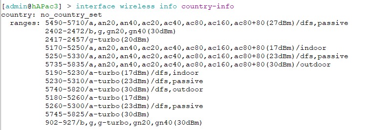

I have no-country set and manual-tx limit so it should run on max power
No-country set is using the FCC frequencies and EIRP levels. This is not what is used in e.g. Europe (ETSI regulation).
If you are not in an FCC region (but something like ETSI) , the smartphone will search for other frequencies than FCC.
https://en.wikipedia.org/wiki/List_of_WLAN_channels
What does ROS use here? Check!
in CLI check “interface wireless info country-info” or “interface wireless info country-list”
