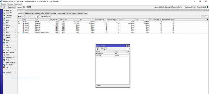

Good evening. I have an OmniTIK 5 PoE that reboots periodically. I tried changing the power supply, but the problem persists, and I wanted to know if anyone has any insight into why this is happening.

The unit is operating solely in bridge mode with no devices connected to the PoE ports; this has already been verified. The cable, connectors, and other components have been checked, yet the reboots continue every 5, 10, or 15 minutes.
Poe 24v
