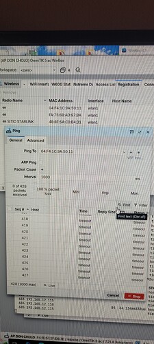

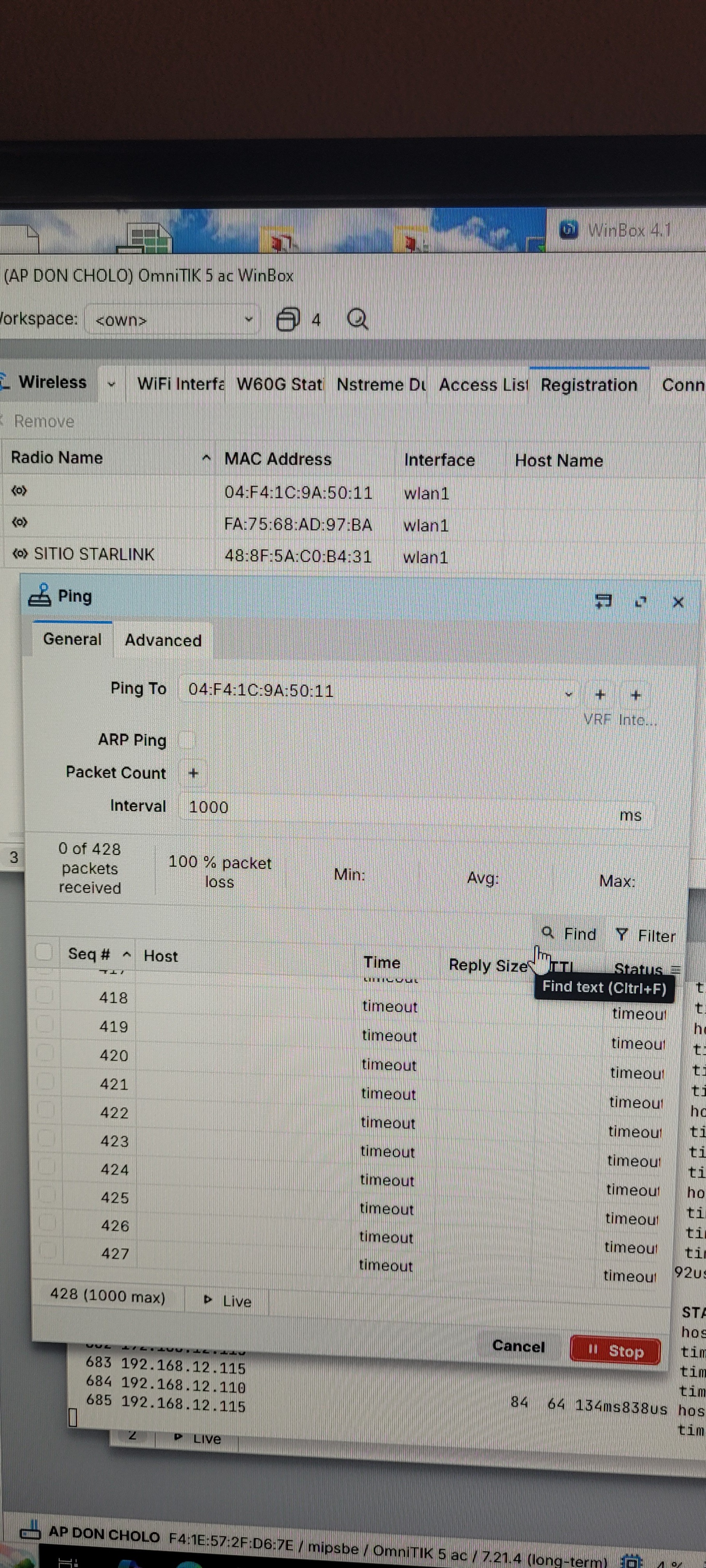

Good morning, I have tried that configuration mode and it still won't connect. That is, the devices can see each other but there is no transparency, no ping.
"I'm sharing a screenshot of the OmniTik, the MAC ending in 50:11 is the SXT 5ac."
