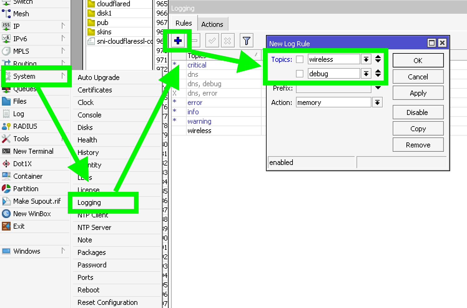

Add a new logging rule with wireless and debug topics. Then watch the Log and see if anything interesting happens at the moment when the users say it is lagging.

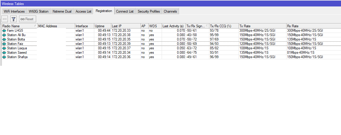

    Right now I can say the following you have a very low signal from clients for a distance of up to 600 m. If properly configured Litebeam M5 can work at a distance of 5 km or more. By adjusting exactly the direction to the antenna you should get the maximum signal Tx in the registration table. You have to get a signal stronger than -60 (now it ranges from -64 to -40) Then by adjusting the power on the client you have to set the Rx signal to about the same for all and again it has to be -60 or stronger. (right now it ranges from -75 to -58)

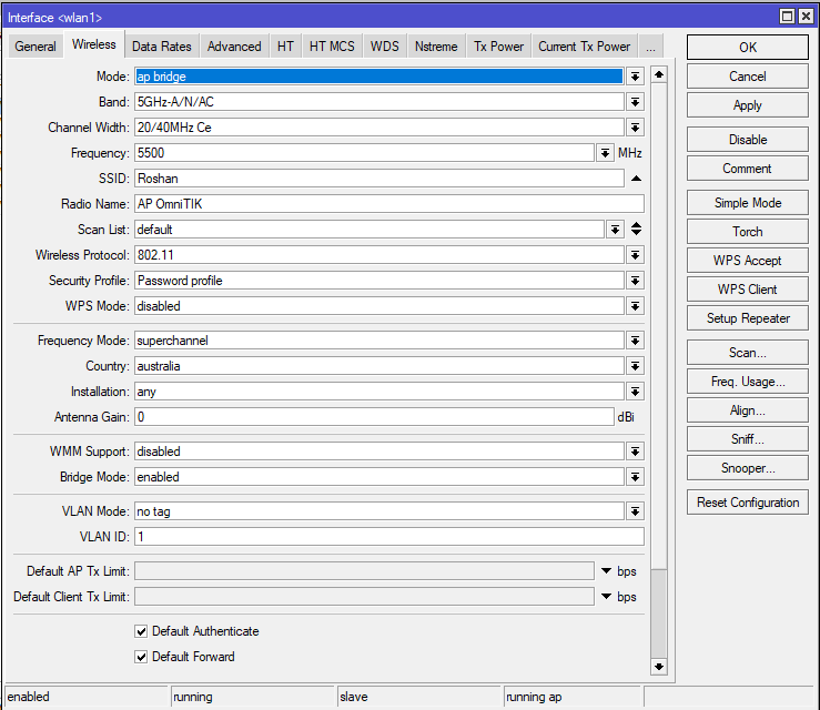

    You have all devices of standard n, so select “n only” in the settings. This will slightly increase the overall performance of the network.
    For the Omnitik 5AC, it is more correct to choose ac devices. Microtic SXTsq 5 ac, DISC Lite5 ac, LHG 5 ac or Ubiquiti LiteBeam 5AC LBE-5AC-23
PS On a device that receives -40 signal I would remove the side lobes of the dish, which would reduce the gain

How to add a new rule with wireless and debug topics?
If I select Band 5Ghz N only then what will be the impact on my client?
They will work smoothly or they have a data transfer limit AP to station when selecting 5Ghz N.
