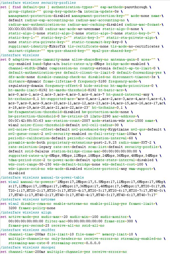

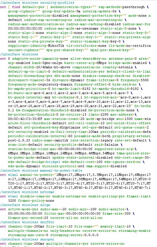

Can you post /interface wireless export
I attatched the wireless export images from the Omnitik and one of the SXT
