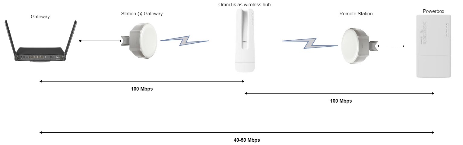

We’ve noticed some issues on one small site that was deployed years ago. We are currently using an omnitik as a wireless hub with an incoming and outgoing feed off it. Please see attached photo for the basic network diagram. We understand that the duty cycle can be a big factor in this problem as the omni can only transmit or receive at a time.
The question is, is there a configuration (without adding gear immediately) on the omni or sxts (stations) to optimise the network? With fibre installed on the site, it will stick out like a sore thumb.

Your scheme is not exact, that’s why I don’t understand the reason
PS Why do you limit the speed of ht-basic-mcs=mcs-0,mcs-1,mcs-2,mcs-3
If you have only one channel then you need to disable ht-supported-mcs mcs 8-15
And if you still have two then you need to change ht-basic-mcs to mcs 8-15 this will slightly increase the speed.
If the signal level is so weak that mcs 4-7 do not work then mcs 12-23 must also be disabled

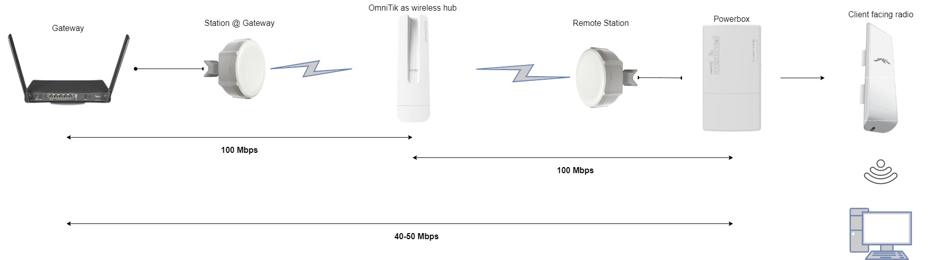

Hey, thanks for the reply.
Here’s an updated network diagram, to help you understand. Having the omni in-between the sxt’s is what I meant by a wireless hub. We’ve got a nano at the end of the network, facing the clients.
We are getting a 100Mbps if we are only doing a speed test from one leg of the network, example: gateway to the omni and omni to the remote powerbox. That 100Mbps drops to around 40Mbps if we do it end-to-end. CPU’s not spiking to 100%, we believe it’s just the link.

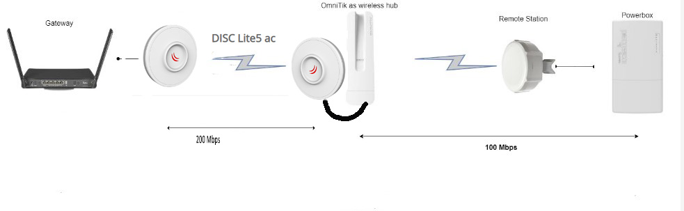

Keep in mid that if Omni serves both SXTs with same radio, then each and every ethernet frame passing the wireless bridge uses air time twice. Add a bit of processing overhead/delay on omni and some performance degradation due to increased number of collisions and it’s more than understandable that overall throughput drops to less than half of realistic maximum available from omnitik’s radio.
Omnitik’s radio is a a/n with theoretical maximum wireless rate of 300Mbps. Realistic payload throughput is mostly a bit less than half of theoretical maximum, so something a bit higher than 100Mbps (and that’s what you’re getting). Then add double air-time usage due to using omnitik as wireless hub and you get what you get.
In the default installation you set ht-basic-mcs=mcs0-8. I advised you to set “…ht-basic-mcs to mcs 8-15 this will slightly increase the speed.”
A radio engineer will always tune the unit manually better than an automatic tune.
You have a bad network design. Using OmniTIK as a repeater greatly reduces the overall throughput. I would recommend upgrading your network now. Install a separate radio bridge to the OmniTIK.
As a last resort, install a DISC Lite5 ac or SXTsq 5 ac first on the OmniTIK side only and eventually replace the SXT Station@Gateway
