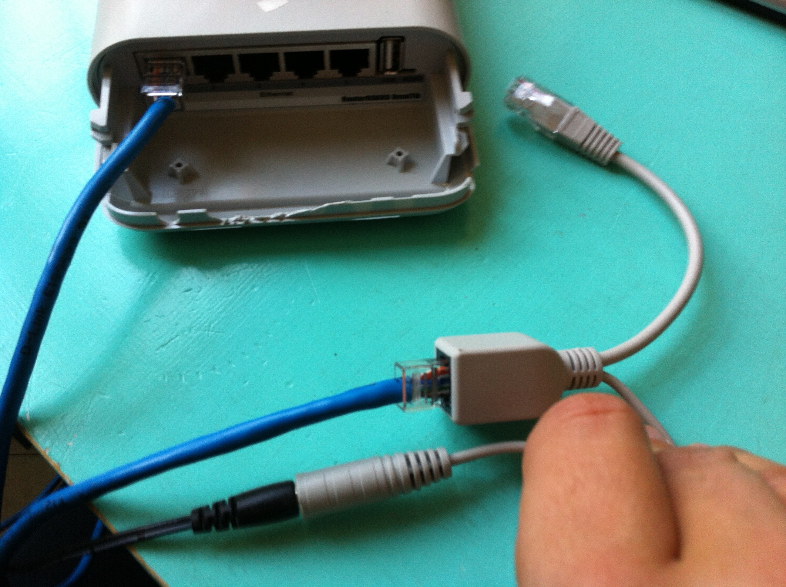

this is what I meant:
Yes I did plug it into PC and set Ip4 to : 172.18.1.5 , same subnet of crashed Omnitik.

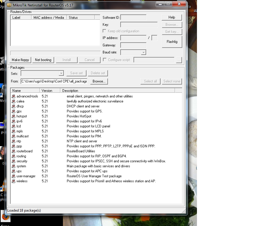

I run Netinstall program and kept reset button for 30 seconds, but nothing is popping up…

http://youtu.be/cFFgdgq0ETE
some questions:
  1. try to turn off the wireless in your laptop
  2. is the net boot enabled as in this image? http://wiki.mikrotik.com/images/6/6a/2009-01-27_1224.jpg
ok let me try
yes, wireless off and netbootin and server enabled with 172.18.4.1
any suggestions?
looks like no eth is enabled,
