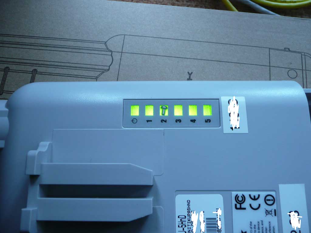

We have lust purchased a bunch of OmniTIK radios to test out and there seems to be a few issues.
  1. I can not get any of the units to fire up the signal strength LED’s

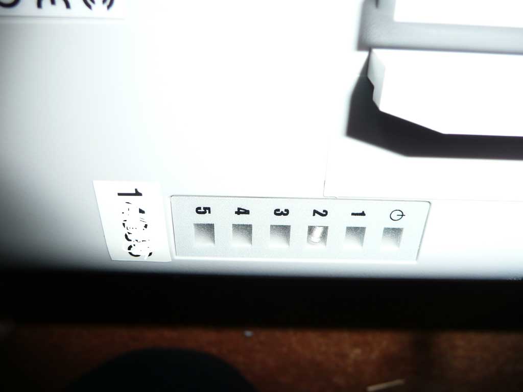

  2. One of the units has a screw lodged in behind the signal strength LED and the window. this is a manufacturing quality control issue.
  3. when set up and being tested the packet loss seems to be pretty high. This is with the unit under test in the workshop in what would have to be an optimum configuration.
“signal strength LED’s”, are you sure? there are no such LEDs on the OmniTik. this is an AP device, there is no specific signal to show (if you have 40 clients, each has different signal), the LEDs on the back are ethernet LEDs
  1. One of the units has a screw lodged in behind the signal strength LED and the window. this is a manufacturing quality control issue.
please send a photo to support, the problem is not clear

As for the screw… here you go.
you can configure each led to do something in the led menu. see all the options. by default they show ethernet activity.
about the screw, please send the serial number to support and we will check. what’s interesting, that omnitik doesn’t even use screws inside.
SN: 2BBF01108D8B/121
