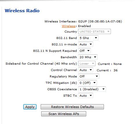

Just got a Linksys N600 USB wireless adapter, still cant see any broadcast from the Omni. What else could i try? can someone look at my config? I’m surprised i haven’t gotten more response on this forum.
Now i know its the OmniTik.
Using this new N600 USB adapter i can connect to a UBEE router that is broadcasting 5GhZ
Below are the settings of the UBEE… question is why cant i get the Omnitik to show up
