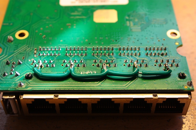

Small update to my soldering poe. I have found that most of my wires soledered on ethernet ports are not necessary. The ground is already connected and the two positive wires of each port are also connected between. So only such simple connection is necessary:
